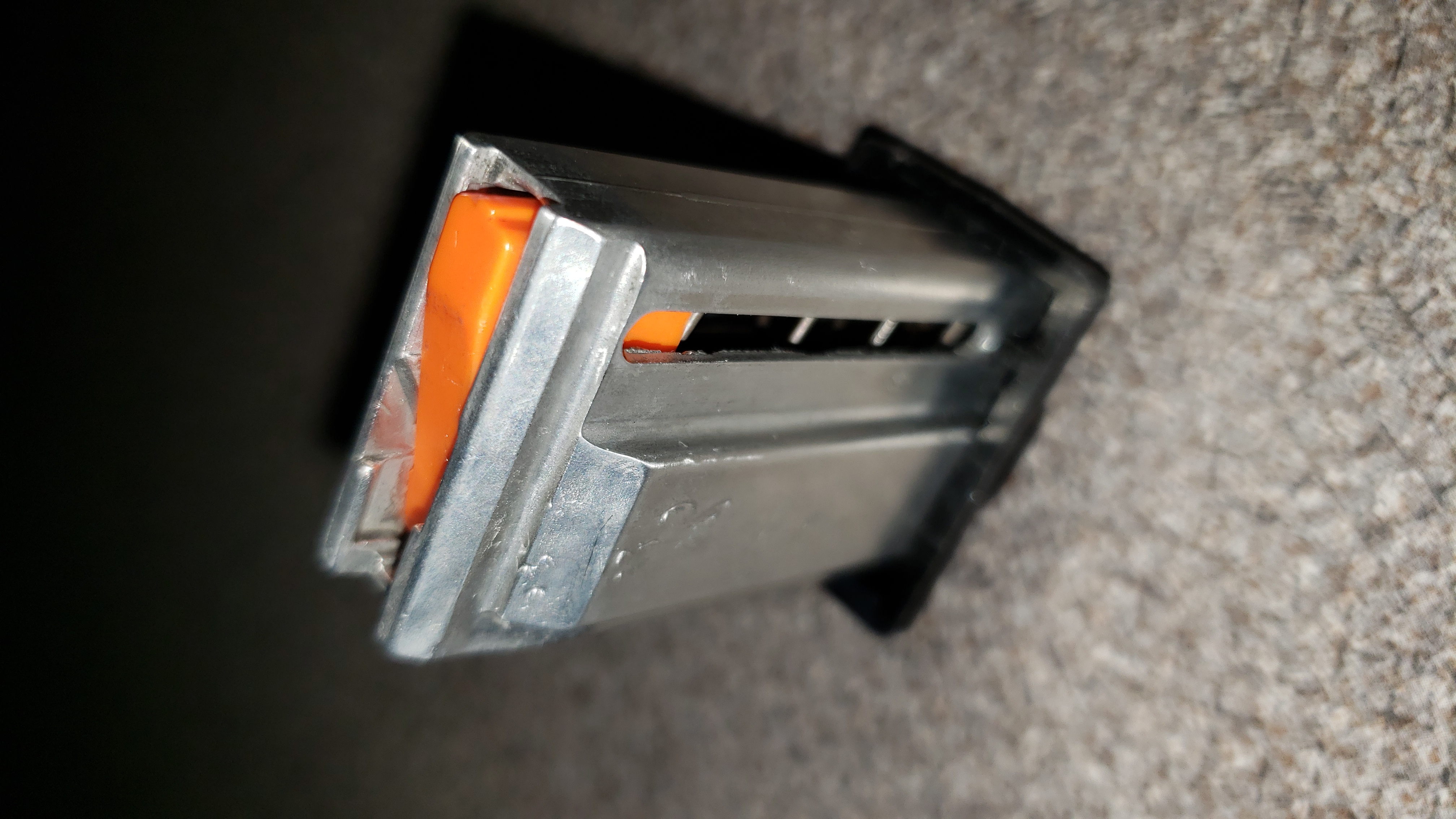

Purchased these replacement springs for my Remington 597 .22LR magazines and they worked great. I have the metal magazines (with plastic base plate and follower), so before I installed the new springs i disassembled the magazine and really had to clean and scrub the metal on the metal body of the magazine (inside and out) with a wire brush, then rised thoroughly with gun cleaning fluid. The metal was actually getting rough on the inside and out which was catching the follower. The weak spring plus the roughness on metal part of the magazine was causing constant feed issues. After the new springs and cleaning my 597 is performing flawlessly. Before you installed the new springs make sure the orange follower goes up and down smoothly. You may need to wire brush the inside of the magazine.
