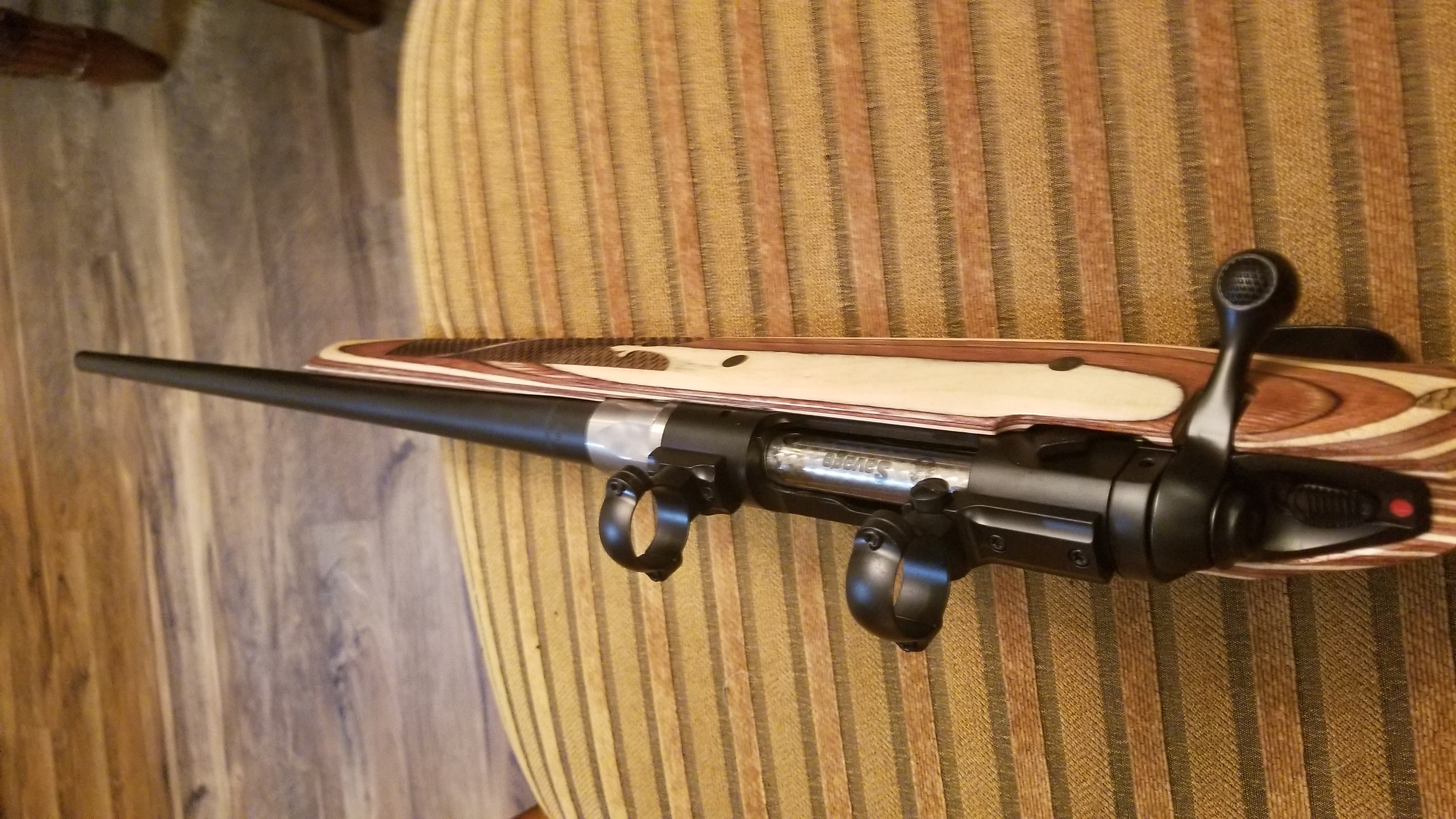

Best upgrade i've done to this gun yet!!
This is a well made kit that substantially reduces trigger pull weight. It will not take out creep or grit felt in the trigger pull before installing the kit. My Savage Axis .223 with hard wood stock didn't have enough side play to fit in both shims. I did install one of the shims which made for a wobble free trigger. The grease provided is outstanding. I'm going to use the left over grease to lube my 1911s and M1a.
