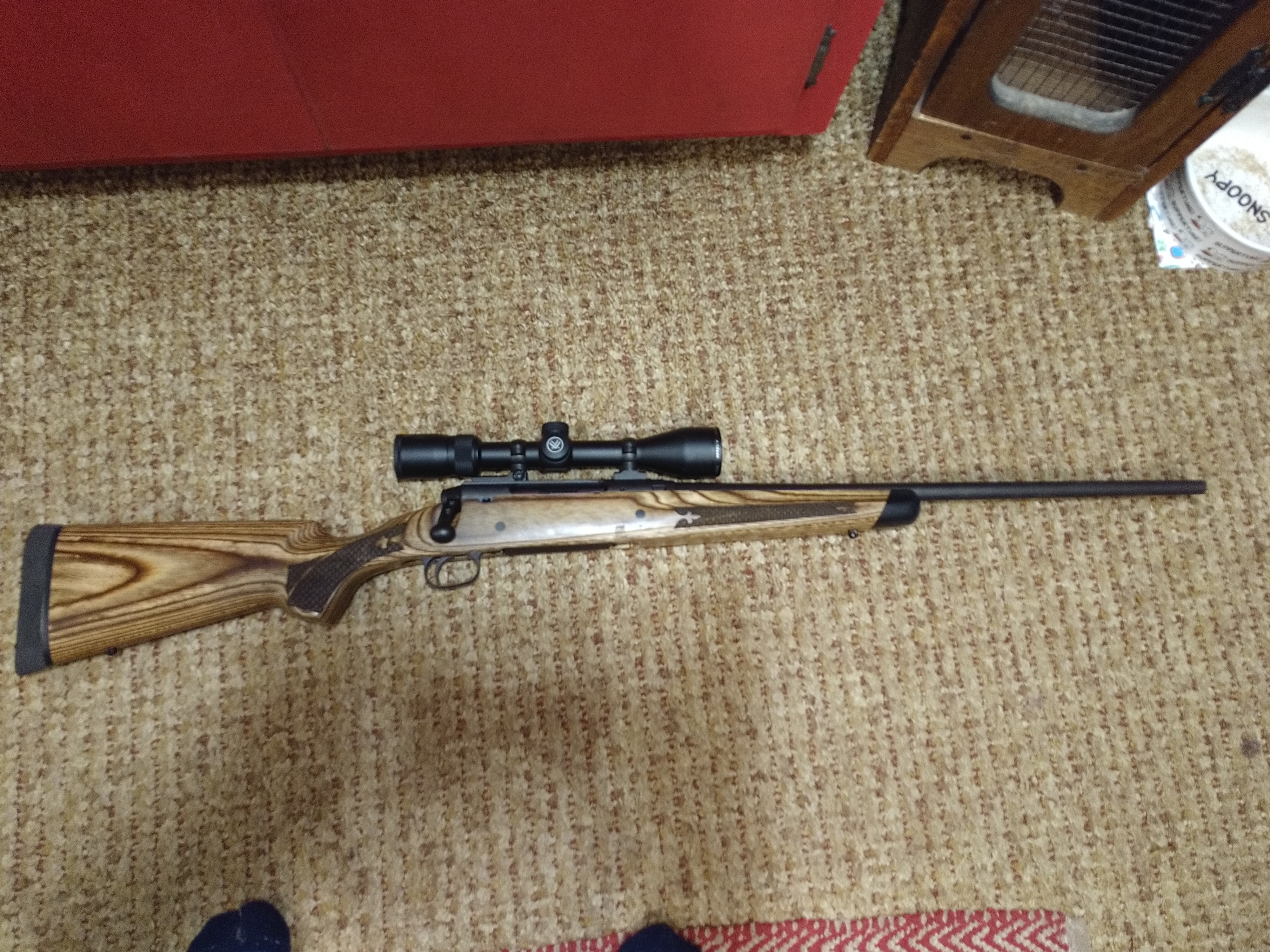

Bought a Savage Axis to coyote hunt with. Like the rifle, hate the factory trigger. Hard for me to hold the crosshairs on target a pull the 7# trigger. A friend bought his grandson a axis a couple years ago, his grandson couldn't pull the trigger, we cut one ring off of the factory spring, it helped but the trigger is still to hard to pull. I started looking for something better and found MCARBO.
I put the pro kit on my rifle and the trigger pull went from 7# to 4#. I now have a rifle I can shoot.
Just ordered 2 more kits, one for the friends grandsons rifle, and one for another friends coyote rifle.
We have a coyote problem on our hunting lease, I think we can now work on that.
One more thing the trigger now pulls straight back thanks to the pro kit shims, no more trigger wobble.
If you have a Savage Axis in your safe that you don't shoot very much, put one of these pro kits on it. They are fun to shoot.
