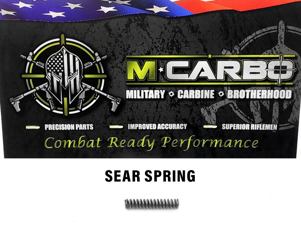

Ruger Mini-14 & Mini-30 Trigger Spring Kit Improve the accuracy and overall performance of your Ruger Mini-14 or Mini-30 with the M*CARBO Ruger Mini-14 & Mini-30 Trigger Spring Kit. This kit is designed to reduce your trigger pull from a stock...
