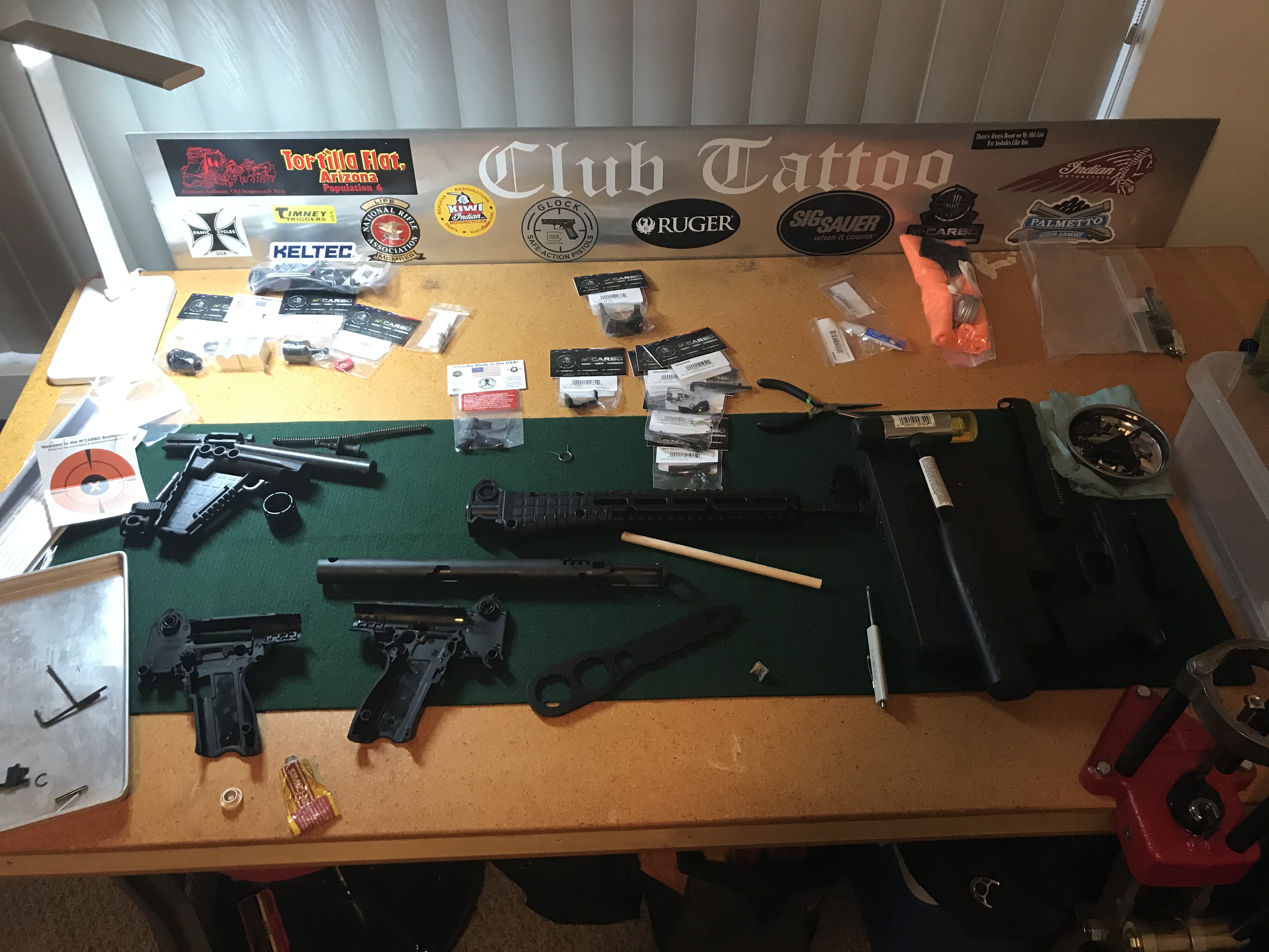

This Kit was not available when I started ordering parts, but over a period of time I ordered everything that is included in the kit, I have installed everything, it was so easy I almost feel like a gunsmith! Chris's videos are the best step by step you can get, and the products are great, my Sub 2000 Gen too looks and shoots fantastic, you can't go wrong with these parts!

The kit is really comprehensive and fairly easy to install if you have the proper tools and follow the instructions. I would highly recommend watching the MCARBO install video prior to attempting this work. One thing: The upgraded sear spring is slightly longer than the stock spring, this caused some interference when i attempted to close the 2 receiver halves. The fix for me was to shorten the longer leg to the same as stock. I used a pair of wire cutters to get this done. And all was good.
