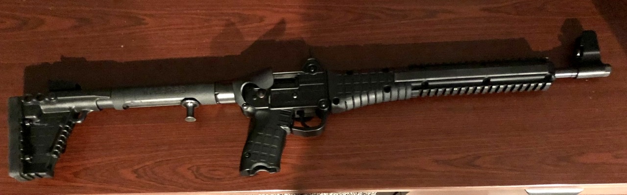

Finally finished rebuilding myKel-Tec Sub-2000 with new M*Carbo parts, Pro Performance trigger job bundle Buttstock Pad, Bolt tube cover, Recoil Buffer, Rapid deployment latch, M-Lock rail covers and Shell Deflector. Yesterday I went to the range and the rifle shot amazing, trigger felt crisp and clean. thank you M*Carbo great job!
