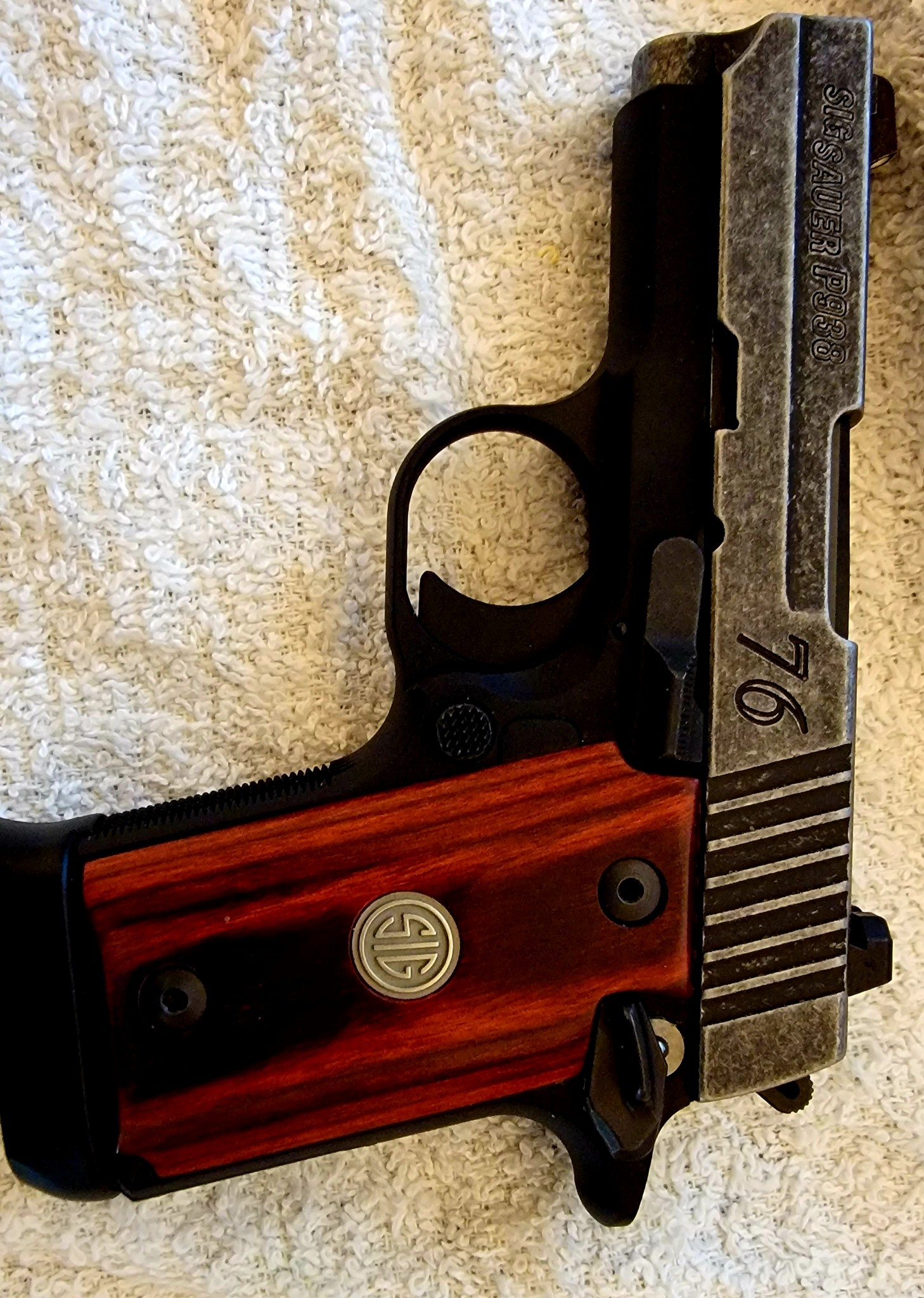

Just completed my installation on My Sig 938, polished feed ramp and trigger contact surfaces, installed spring kit, tested with a Wheeler Digital Trigger scale using 3 pull average readings. Results were, clean, smooth take up, crystal break and pull average greatly reduced. Before spring kit pull was at 5.7.3 lbs. After spring install and polishing pull was 2.7.1 lbs. Significant reduction and great feel improvement for about an 1hr of effort and little expense. Thanks M*Carbo I have another happy customer.

Polished the trigger group and feed ramp, installed MCARBRO springs on my Sig 938. WOW what a difference, lighter, smooth trigger breaks like glass. No more gritty drag! Next I’ll do the same to my Kimber Micro 380.
