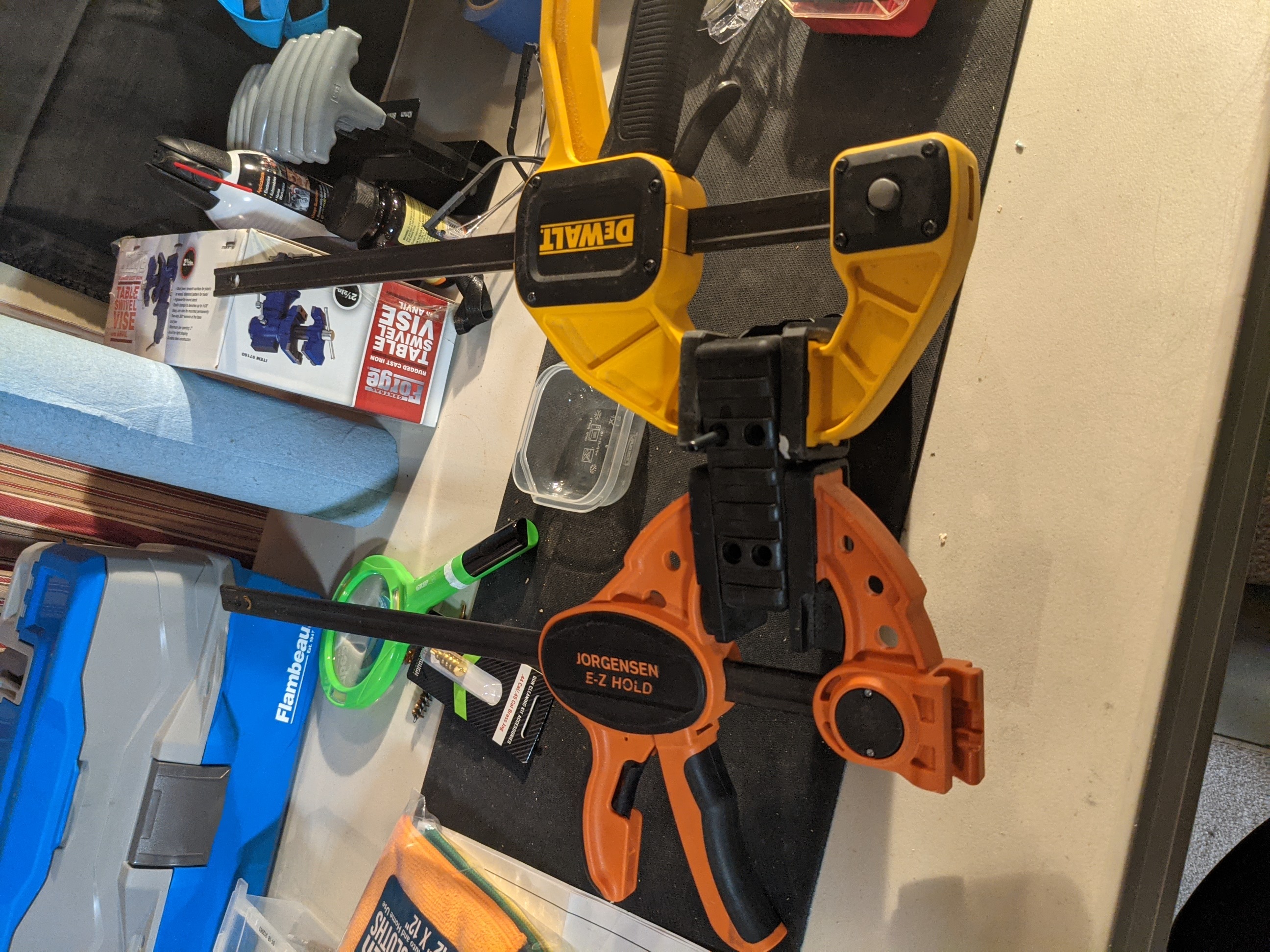

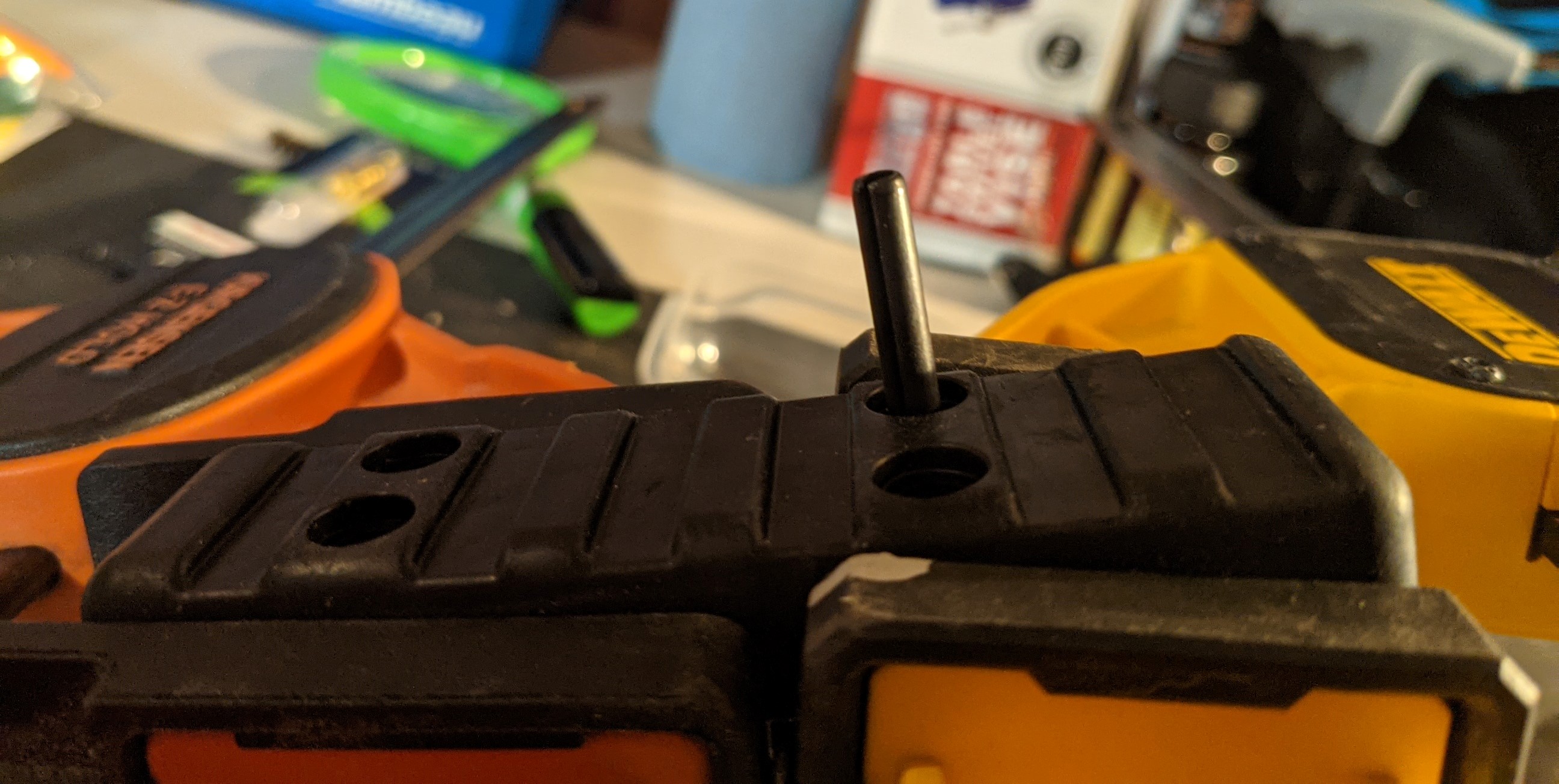

I started by securing the buttstock pad with two trigger clamps. I could have drilled through the existing holes of the pad into the stock but did not want to risk damaging the pad. Instead I determined a 3/16" x 1" tension pin would fit snugly in the pad and provide a straight guide for drilling a guide hole through the stock. Once the initial holes were in the stock, I used progressively larger bits until each hole would accommodate the screws that came with the pad. This process was a little slower but ensured each hole was properly placed. (The idea of scratching a mark and then drilling as in the installation video seemed to just invite having one of the holes off line.) This method also caused the raised area on the inside the stock near the top holes work as a hold for the nuts. In the end, I think anear perfect installation.

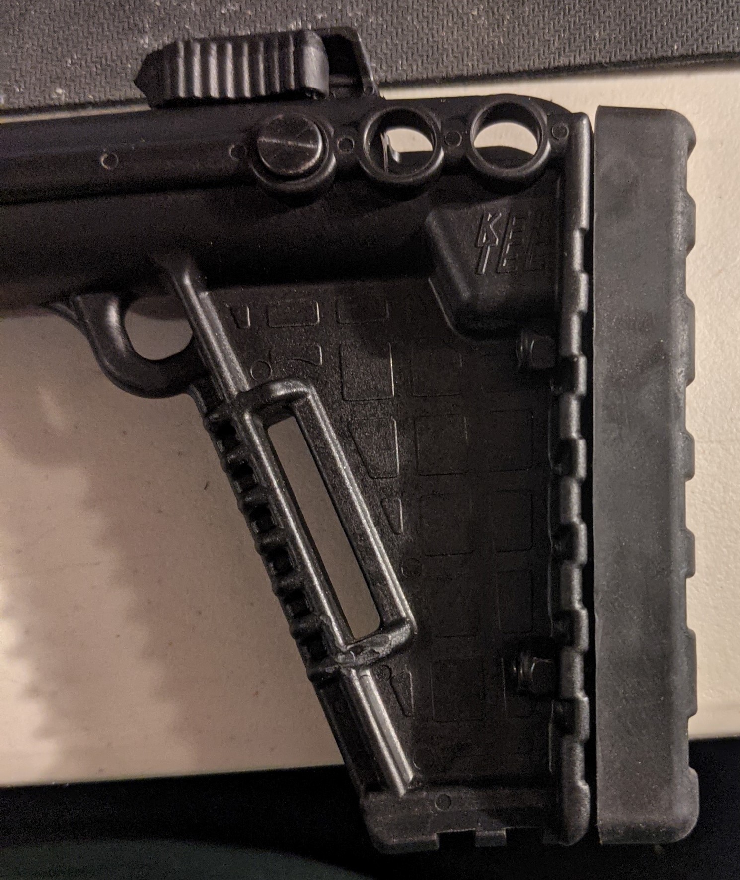

Part fits Sub2K gen 2 perfectly. Easy install with masking tape to hold in place and a drill press. Longer pull length is nice.

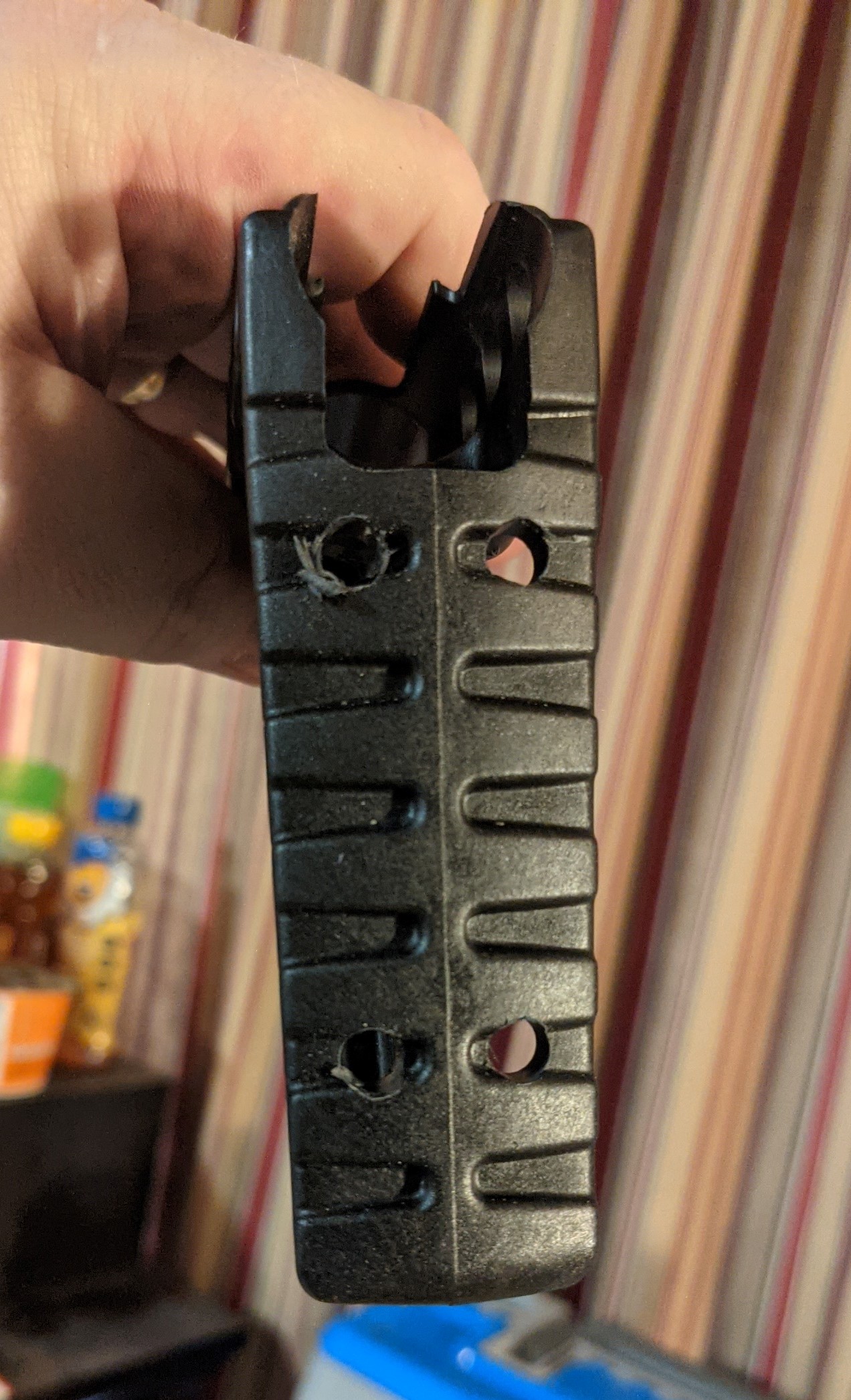

Two stars for comfort, after that it's a crap shoot. Be extremely careful when laying out and drilling holes. To far either way and the nuts will not line up with the screws. If you use any length of pull other than then longest the pad will not allow the sub 2000 to completely fold. M Carbo could at least supply a tacky back template to lay out the holes.
