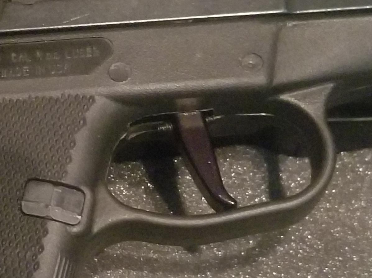

Install was fairly easy. I used the videos for the p-11 trigger spring and the pf-9 flat trigger install. When adjusting the over travel set screw to the right position it makes the the pre travel set screw to long and would not allow the the trigger to reset without pulling the slide back ever so slightly. I removed the set screw and now the trigger is allowed to go forward enough. I will shorten the set screw to remove the trigger pre travel. I have owned my p-11 for over twenty years and it is a hand full to shoot. Overall the trigger pull is a lot easier now. I also installed the 20lb coil spring and trigger spring kit. Looking forward to shooting the p-11 in the future

My old P11 had the most uncomfortable trigger of any firearm I own. I discovered after multiple attempts to utilize the over travel and take up trigger screws, that they just didn't work for me. With any amount of the take up screw protruding, the trigger will not reset, so I left it out. With a long trigger travel before the break, it wouldn't break with the over travel screw installed, so I left it out. Am I still happy? Yes!! The flat trigger and spring kit makes the P11 much more comfortable. A difference of night and day!

But I had a problem, the RESET was horrible! My new trigger reset spring from the trigger kit worked great with the old plastic trigger. So it wasn't caused by the spring. Could not figure it out. I almost reinstalled the old trigger. But, since I wasn't planning on using the P11, so I put it back in the safe. Today, I decided the .380 with 6 rd mags might not be enough, even if I carry a couple of spare mags.
So, I got out the P11 and dry fired it a few time. Yeah, on 'Reset' the trigger would move forward, then stop for a bit, then start moving slowly forward again, until reset was done! Sometimes the trigger would just stop in the middle of reset! I decided to inspect the plastic frame for defects. Nothing seen on both sides of the trigger, looking at the bottom of the frame. Was it shifting sideways? I held the P11 up high to look up at the trigger from below. Nothing seen.
Then, Held the P11 sideways 6 inches from my eyes and saw the problem! The new trigger was too long for the plastic Trigger guard! The tip of the new trigger was dragging on the bottom (inside) of the trigger guard! The factory molding seam was sticking up about 0.1 mm. Some light sandpaper work and my Reset was working perfectly! Now, maybe I can re-install the over-Travel screws and see if it could possible work any better!
