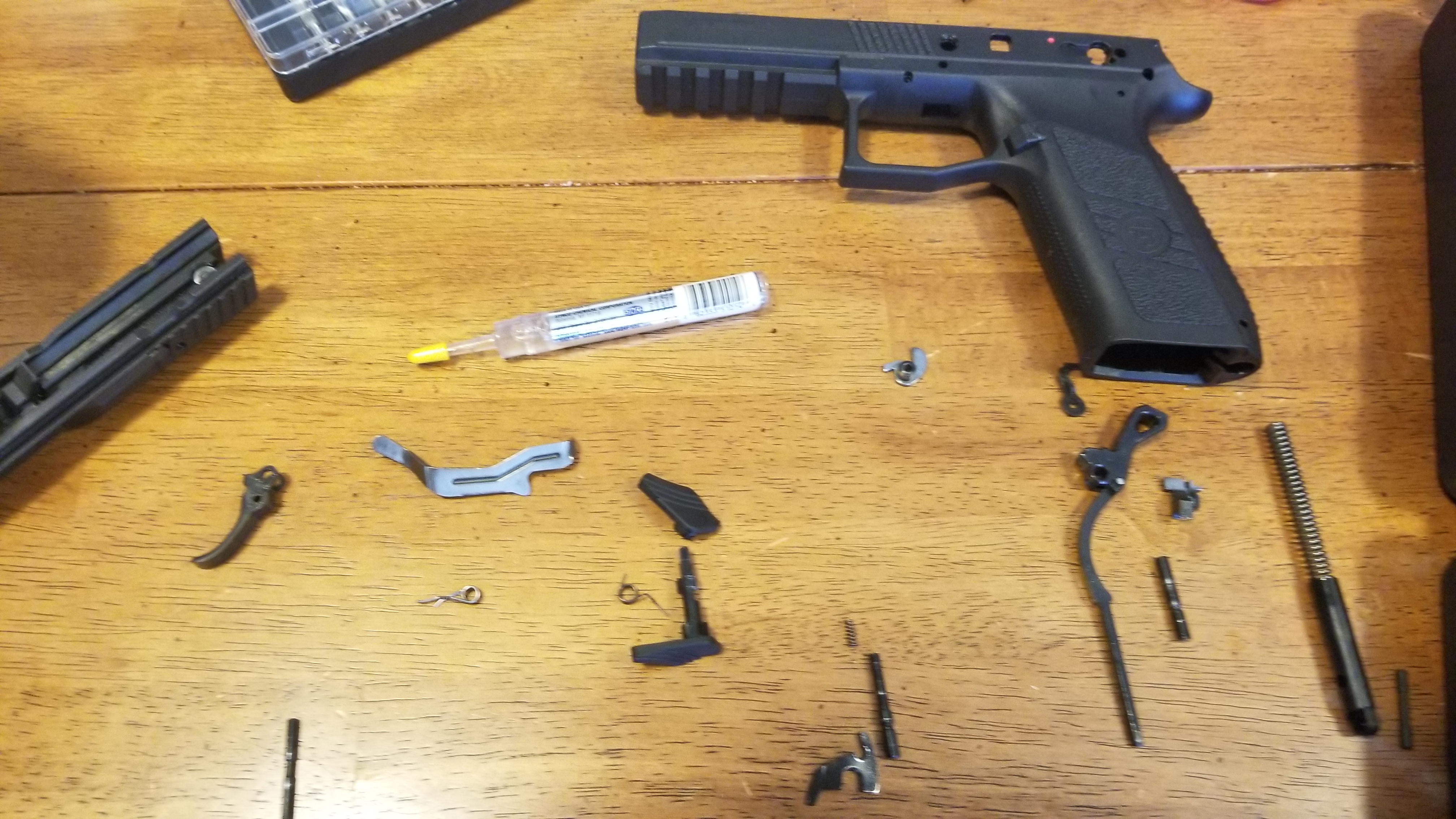

Some time ago I bought a used CZ P-07 that had been sent to Cajun Gun Works (CGW) to have their “Pro Package” installed. I absolutely love that gun, and have a great deal of respect for CGW, their products, and their work. So much that I ended up sending two more of my CZs to have them install their Pro Package installed, and they came back awesome. I liked my P-07 so much, I thought it needed a big brother - so I bought a P-09! The trigger out of the box on my P-09 was not that bad, but certainly not as nice as my P-07. I didn’t want to spend hundreds on another CJW job, but I wanted a better trigger. I was rather skeptical of the M*CARBO kit - which is a fraction of the cost of the CGW Pro Package. But for the price, I was willing to take a chance.
I enjoy working on guns, but had never done anything with my CZs other than basic cleaning. They seem a good bit more complicated than a Glock or something. So after getting the kit, I watched the “How To” video all the way through, then headed to my workbench with my iPad to have the video for a reference. I took my time, and with the excellent video as my guide, I dug in. I won’t say it was easy, but if you take your time and keep referencing the video - it’s really not that difficult.
Now for the results! I have a trigger pull gauge and measured the pull on my P-09 before I started. Double Action (DA) came in at 9 lbs, 1 oz. Single Action (SA) was 3 lbs, 13 oz. The trigger was fairly smooth. When I disassembled the gun, I didn’t find a lot of roughness anywhere but there were a couple of areas that needed some sanding. I also polished everything with the M*CARBO polishing kit. After reassembling the gun, I again measured the trigger pull. DA is now 6 lbs, 5 oz. SA is now 2 lbs, 3 oz. The trigger is a bit smoother in both DA and SA. By comparison, my P-07 with the CGW package measures 7 lbs even DA, and 2 lbs 11 oz SA. The reset on my P-07 is shorter, because CGW includes parts designed to shorten the reset. The trigger on my P-07 may be slightly smoother, but only slightly.
Bottom line (after all my rambling): The M*CARBO kit is a tremendous value that will give you a noticeably improved trigger.

This was the first trigger job I’ve done on a pistol myself and this kit was fantastic. The video of the install made it easy. This kit is amazing and the pull is no lie. All the videos online of this kit don’t do it justice. Amazing kit, quality stuff, and totally transforms the gun. Nice work MCarbo! I’ll be buying more of your stuff

Honestly for the price, you cant beat it...especially since theres a super detailed video to follow along to install the product! I have to say installing this kit and adding the polish kit with it is like night and day, super buttery smooth, and very happy with this product!
Before install:
DA 10lb 7oz
SA 3lb 9oz
After install:
DA 6lb 3oz
SA 2lb 8oz
