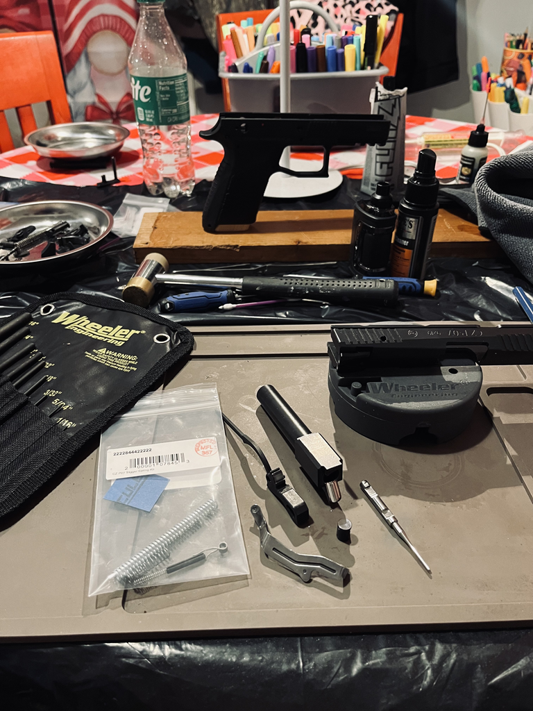

This was my 1st time doing a project like this. I followed the instruction video step by step and fully polished the trigger bar, hammer and sear. With my dremel and flitz. The kit and polishing worked wonders for the gritty stock trigger pull. The only issue I had was reinstalling the decocker, it gave me fits, I ended up setting it down for the day. The following day I found a video that used a slightly different method and it went together in 10 minutes. Over all I spent about 3-4 hours total on it, learned a lot about how things work and am 100% satisfied. Thanks Mcarbo!!
CZ P07 Spring Kit
Just finished the install today and the results are very good. DA and SA are both smoother and have noticeably less trigger pull weight. The video on the install is excellent; however I do have one recommendation: mention the ejector spring before removing the ejector. I removed all and then the video recommends leaving the spring installed - yup, no spring left in my receiver. As an aside, I called CZ USA and ordered two springs and they arrived in two days.
I think doing this install in within the capabilities of most reasonably capable people. The hardest part was installing the decocking lever! I would try, rest, try, rest until after 8 tries I got it! Then noticed I didn't have the small arm of the spring under the lever's platform. After fixing that and two more tries it went together.
Fairly easy install with good results. Also get to learn in greater detail how this pistol works.
