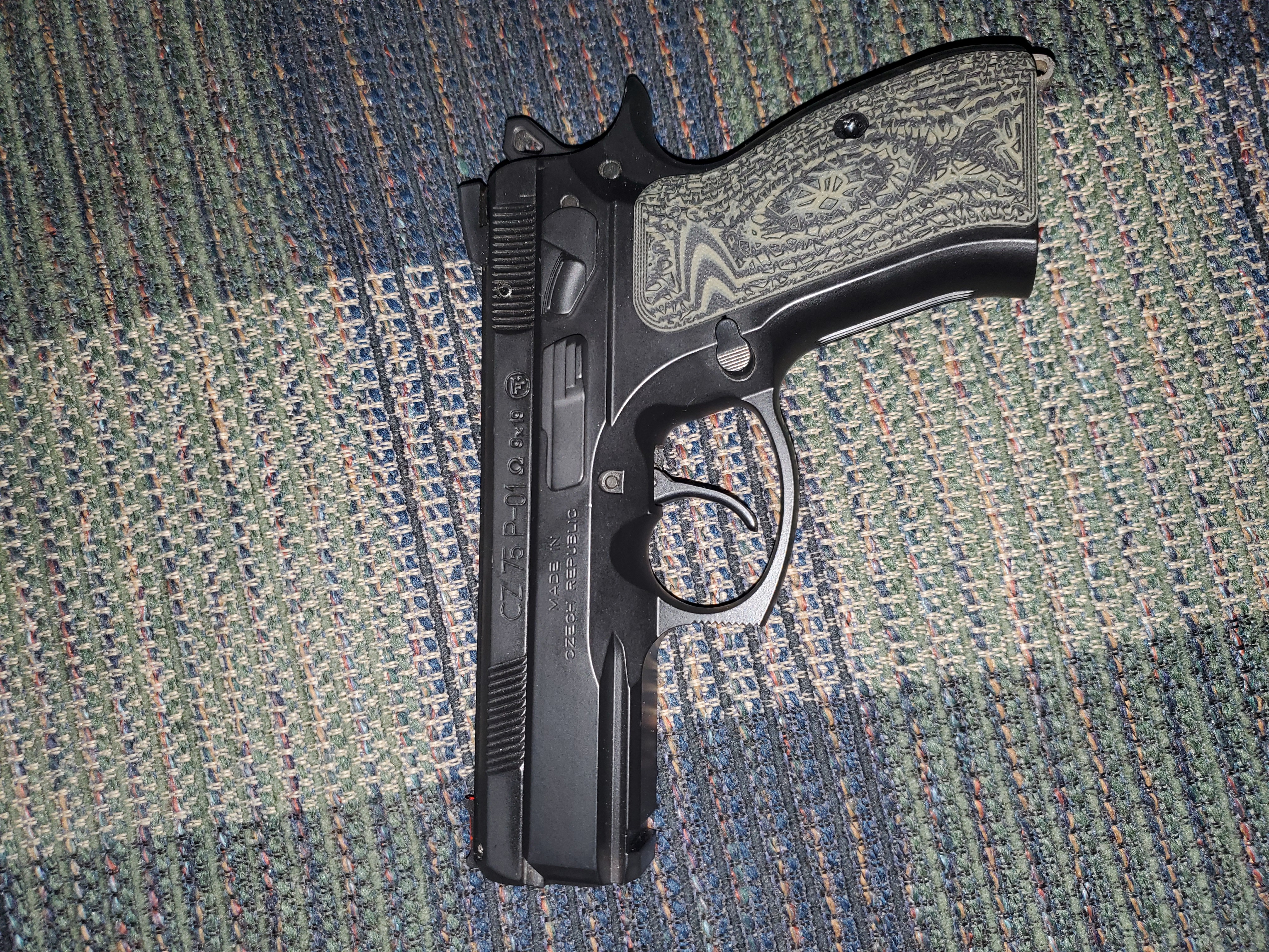

Outstanding product and great video made it easy to install! Bought a kit for my P-01 and for my SP-01 decockers. night and day difference with the trigger pull
CZ 75 P-01 Omega
I installed the kit with relative ease - It’s no Glock part swap but it was very manageable for someone with even modest experience working on firearms. This is the only upgrade I’ve done to this pistol so far and the reduction in trigger pull weights seem to be as advertised and I’m pleased with the results.
I wish MCARBO had an install video specific to the Omega trigger system as the sear spring replacement is quite different from the typical CZ75 and wasn’t immediately obvious. But a quick look at the owner’s manual parts diagram sorted it out well enough.
