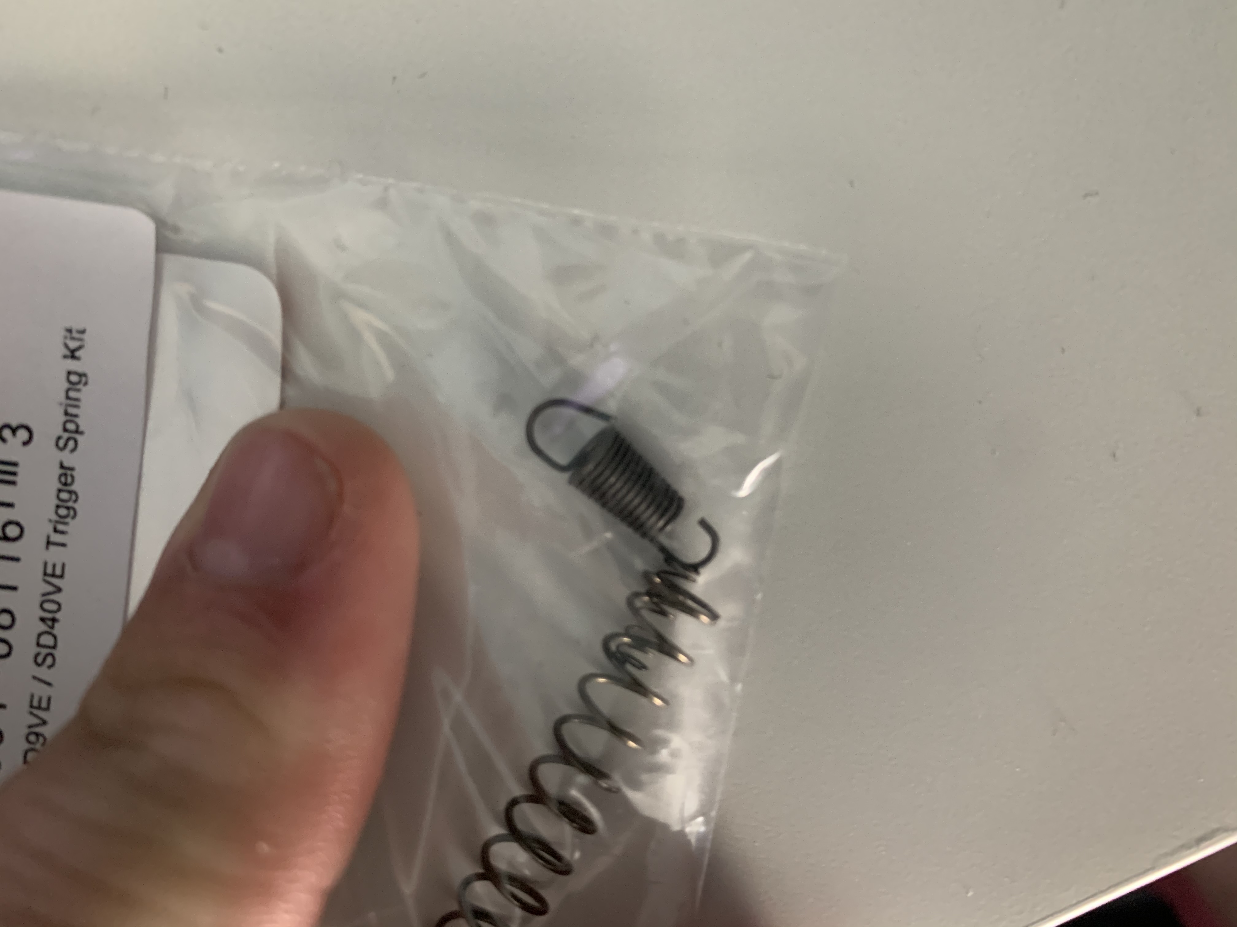

Poor craftsmanship
I purchased two of these kits one for my Sd40ve and one for my Sd9ve. I got them in a timely manner which was good but when I opened up the first package I noticed that the trigger spring was open on both ends not looped like it supposed to be. Had to push the end of the spring into the coil. So looked at the other package and the spring is the same way. So just pushed the end of the spring into the coil. The alignment tool is to small and just kept getting in the way of setting the pin in. I’m hoping it will still work as described even though the spring wasn’t looped. Haven’t had a chance to shoot it yet will update when I do
