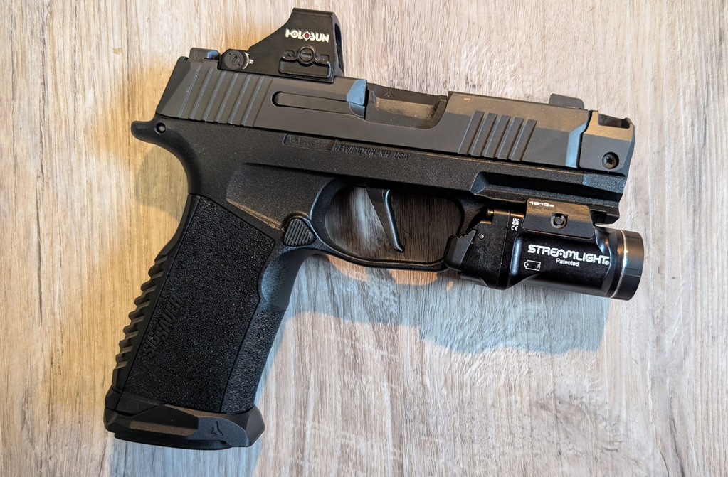

My p356 trigger had an eight pound trigger pull before I installed spring kit. Now it is four pound, fourteen once’s. It’s a joy to shoot now! I would highly recommend this spring kit.

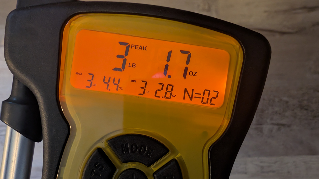

I used the kit to replace the factory springs of my Sig 365XL. The trigger force went from 6 lb 11 oz to 4 lb 13 oz (Wheeler gauge 10 redaings each). The trigger also feels very good without being unsafely low. Changing the springs is a bit more involve than what I did before on other guns, but the video is a big help. Note that the rear plate removal is slightly different on the new Sig models (at least mine), also I had to remove the safety lever and reinstall it (not difficult). You can find youtube video for both.

My stock trigger was gritty. I was looking for something to relieve the grit. I saw an ad for the MCARBO trigger spring kit, so I gave it a shot. Man am I glad I did. The trigger on my P365 XL is so much smoother and lighter now. The instructional video was spot on for most of it. The only variation is had to contend with is that the striker housing on mine is the newer style, while the video shows the previous version. I had to watch a separate video to help with that part, but other than that, spot on. I had no issues changing the springs out myself. Much better feel now. Still need to shoot it, but dry firing it, I can tell a huge difference. Thanks MCARBO!
I just got it back from my gun smith. Exactly what m carbo states. Smooth and crisp. No over travel. I'm gauge at average 3.3 pounds. Great value for the money.
