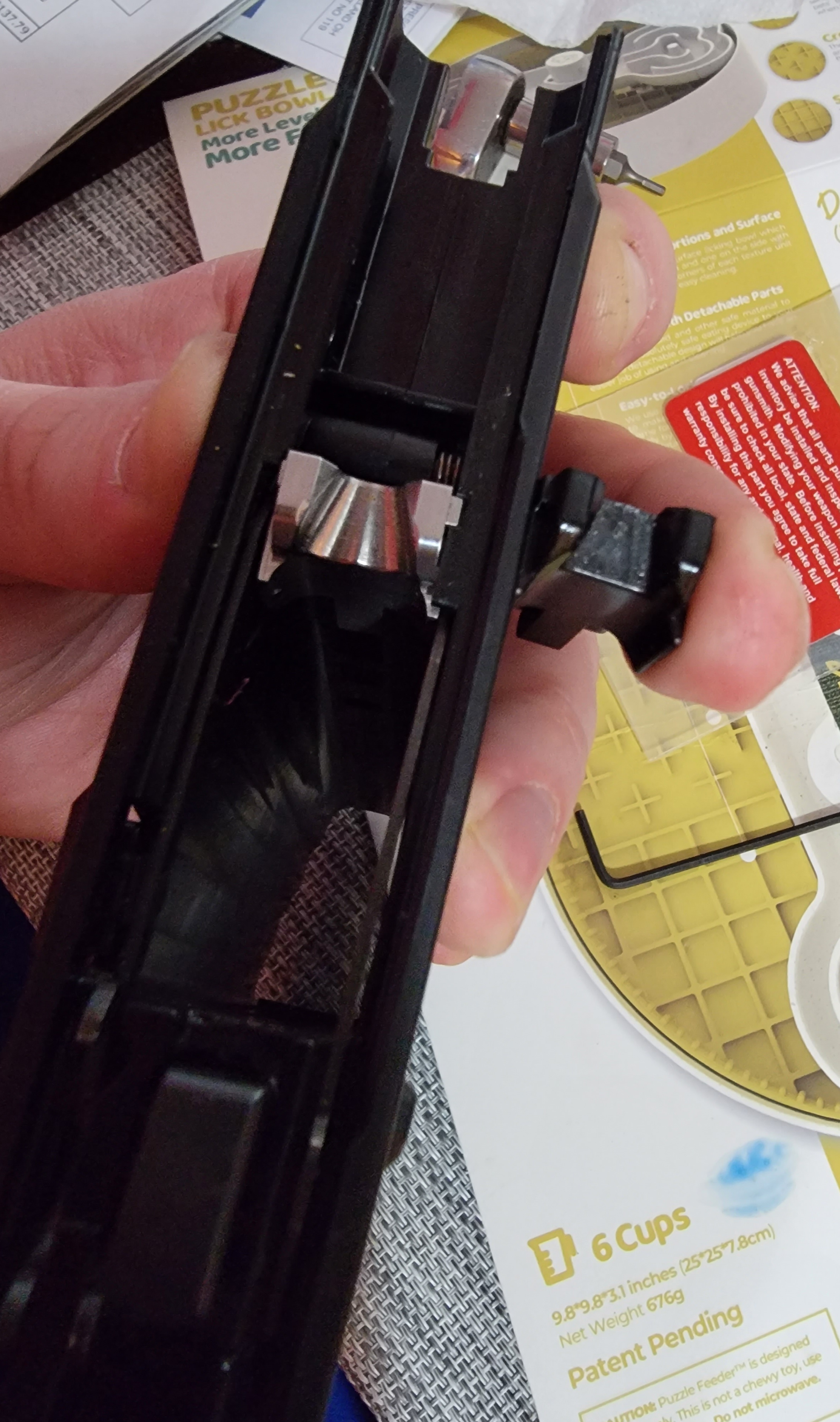

Close-up of KEL-TEC PMR-30 Stainless Steel Feed Ramp Installed in PMR 30

When I first purchased my PMR 30 I was getting tons of feed failures. Like most I did a little research and found that I wasn't the only one experiencing this particular challenge. That led me to MCarbo. This is a well machined quality ramp. Obviously more high quality than the stock plastic one. This in combination with the MCarbo mag release solved my issue completely. I took it out to the desert today and shot 300 rounds of CCI Maxi-Mag with zero failures. One additional tip I would give everyone is to oil your entire slide and the magazine ramp where ever it touches the the inside of the mag. (You will have to remove the bottom of the mag to do this, super easy) Gun is flawless now. Highly recommend.
