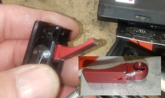

Did not fit my LCP1 with a dash in the serial number, but I modified
The trigger is designed for a newer release of the V1 LCP. I have a very early model, and the trigger hole has rounded ends. The trigger went in, but would run into interference on the frame before the sear would disengage. So. I could see in the red anodizing the contact location, and carefully hand filed to to remove the interference. After many trial fits, I got it working fine. Don't need the 3/32 - 4X40 set screw for over travel because the trigger now touches the frame just after sear release. After solving that, the trigger after max pull would sometimes stick back, jammed against the plastic frame. So out came the file again. remove in a little 6061 on the back, bottom of the trigger fixed that. The anodizing is now butchered, but I really love the final results. Helps to be a mechanical engineer, with my own CNC machine shop. These small changes could easily be incorporated into the trigger production, just a small Cadd/CAM change, and the DASH serial number LCP1 is solved.

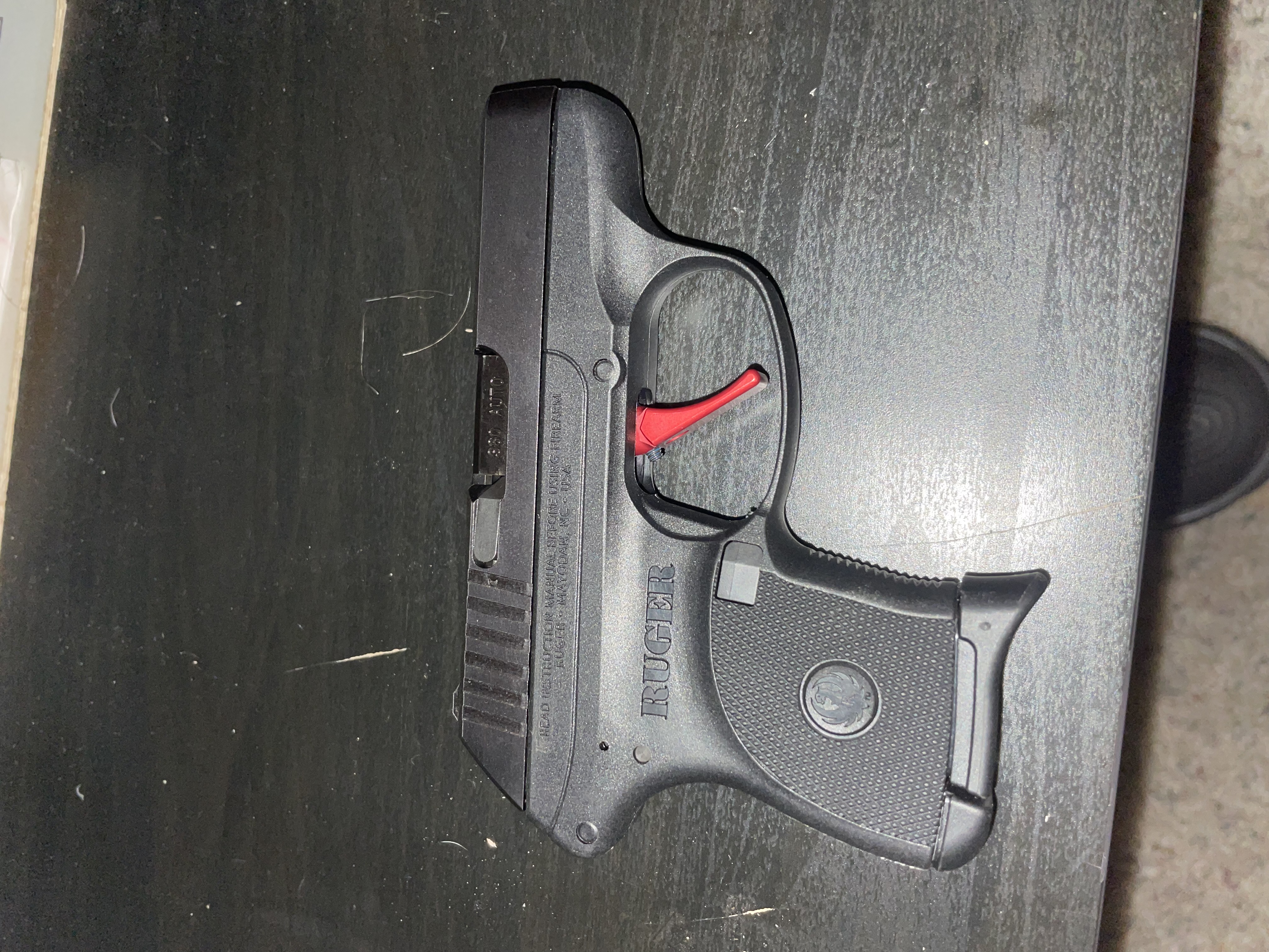

Adjusting the pre-travel and post-travel screws in the frame is not intuitive/easy.
Great Products
Installed the trigger and spring kit in my LCP. What a huge difference! 6.5# pull went to 4#. Something many don't talk about is the reduction in force needed to rack the slide. I found the lighter rack to be a nice side benefit. Great products, great service and great instructional videos. Thanks!
