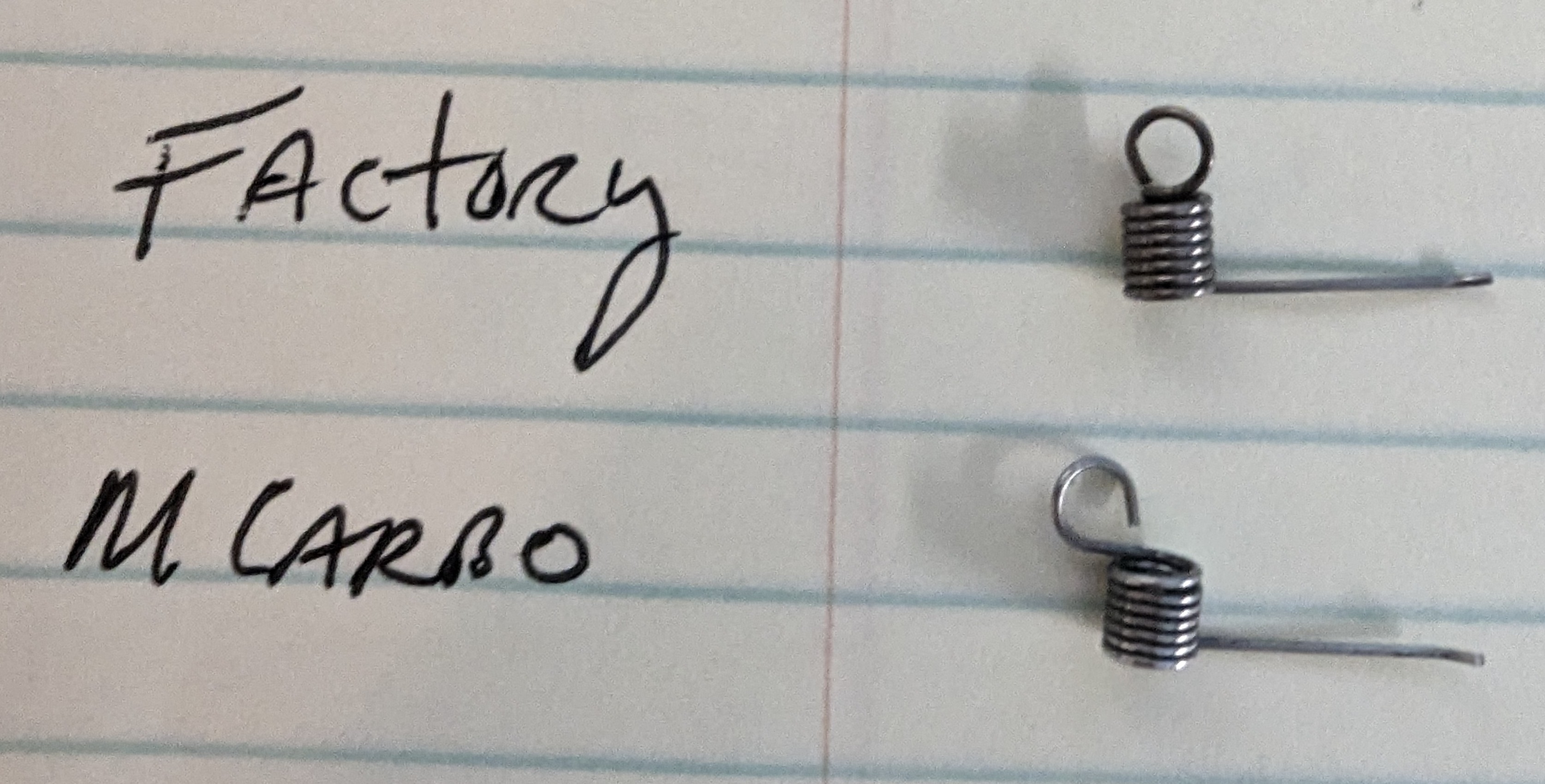

Somewhat of a pain to install following the video instructions. I did not order the flat trigger upgrade but did follow the instructions for installing the trigger spring. Only the trigger spring supplied did not match the web site photo and I assume was only for the flat trigger upgrade. I did send in a support request along with a photo of the stick spring and the differently shaped spring supplied with the kit (no response at this time). So reinstalled the original trigger and spring.
Result is an easier pull, just not sure what to do about the incorrect trigger spring.
