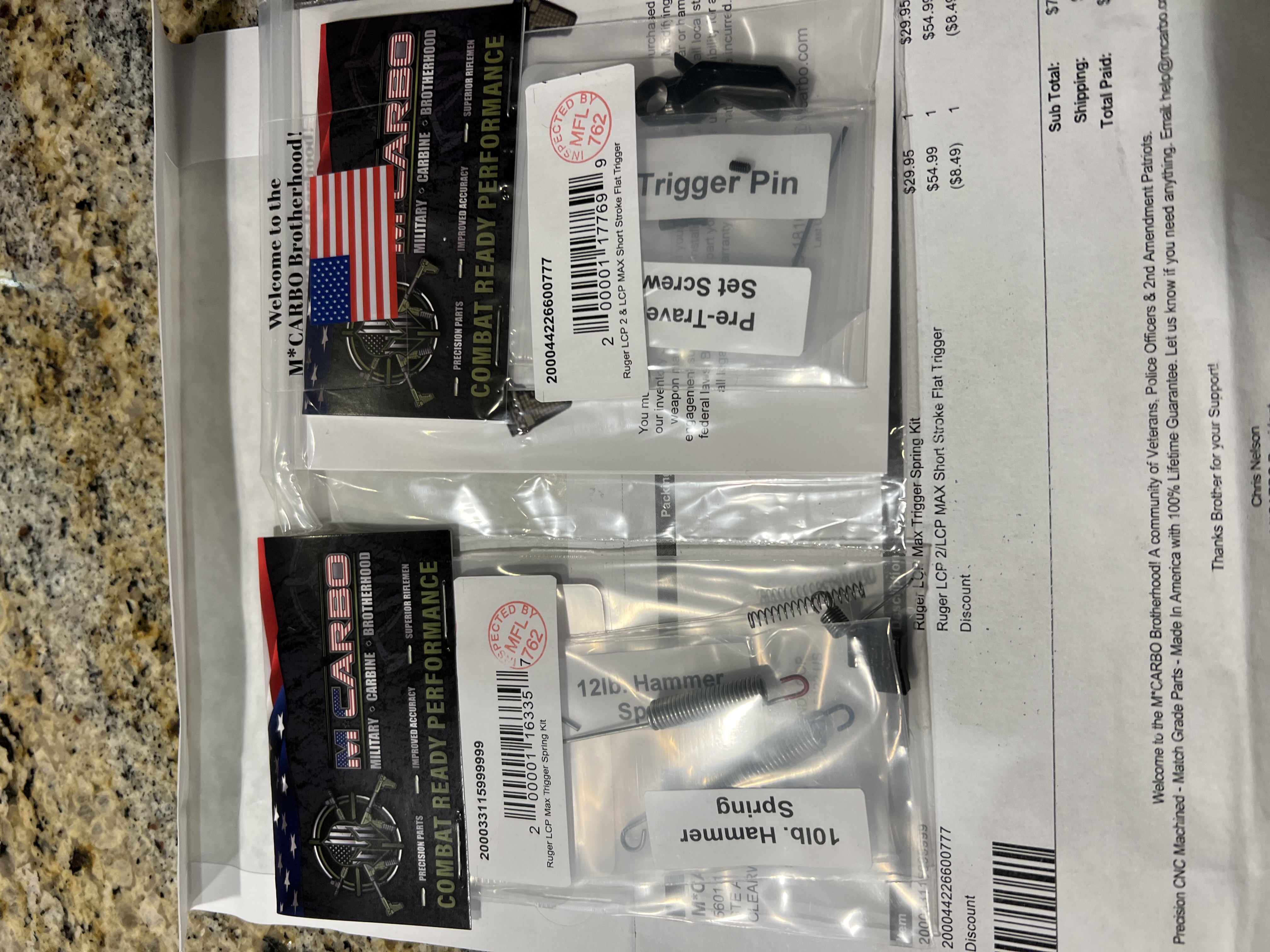

Ruger LCP Max Trigger Spring Kit and Ruger LCP & LCP II MAX Short Stroke Flat Trigger installed at the same time.
1st time out after installing both kits (10Lbs Trigger spring), failed to fire 5 rounds, then rechambered one round, it fired. Changed to the 12Lbs trigger spring. Fired every time.

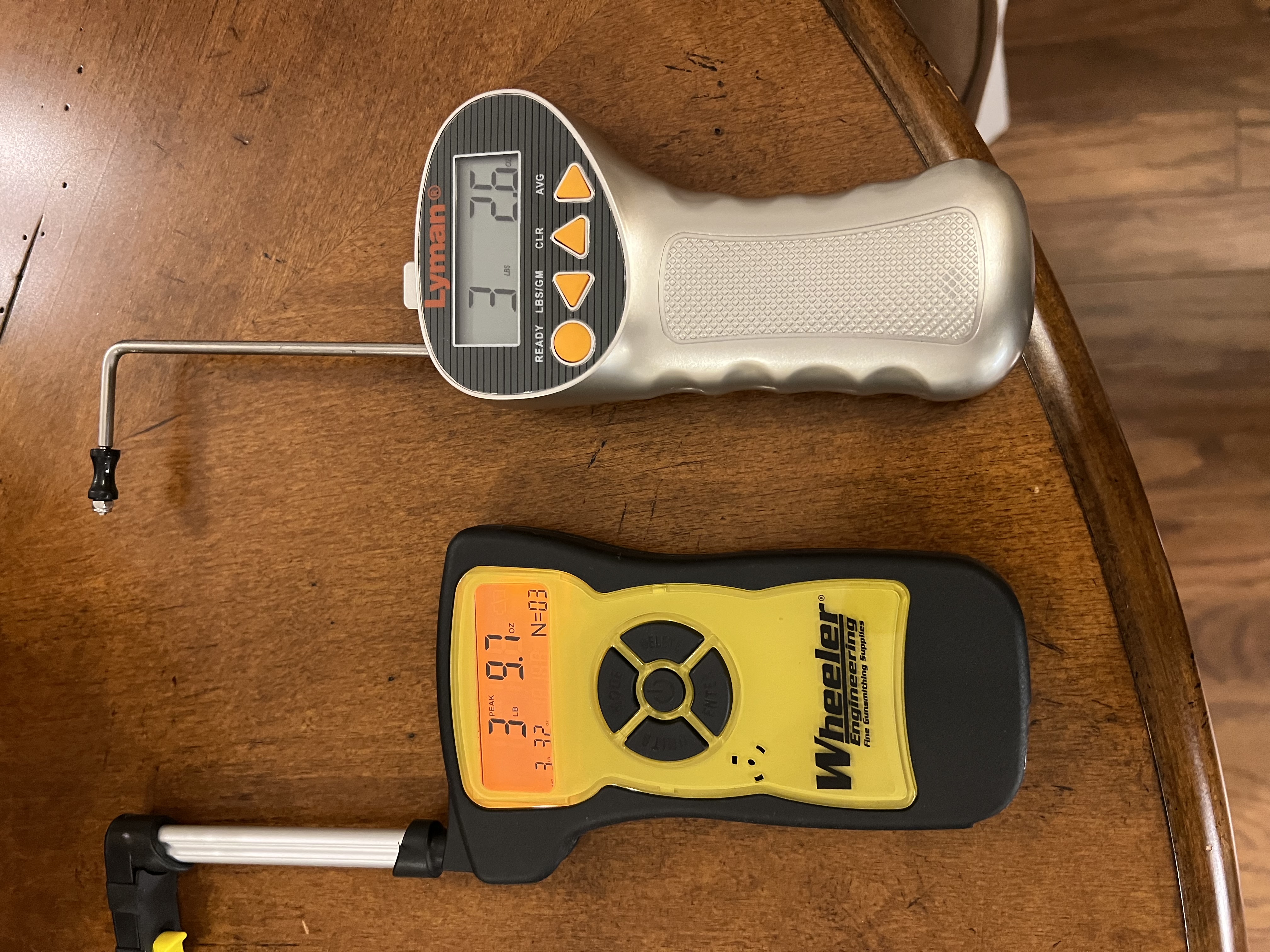

The stock trigger pull averages 6.9 lbs. I installed the 12 lb first, averaging 4.8 lbs. Then installed the 10 lb and averaged 3.97 lbs on the Wheeler gauge and 3.26 lbs on a Lyman gauge.

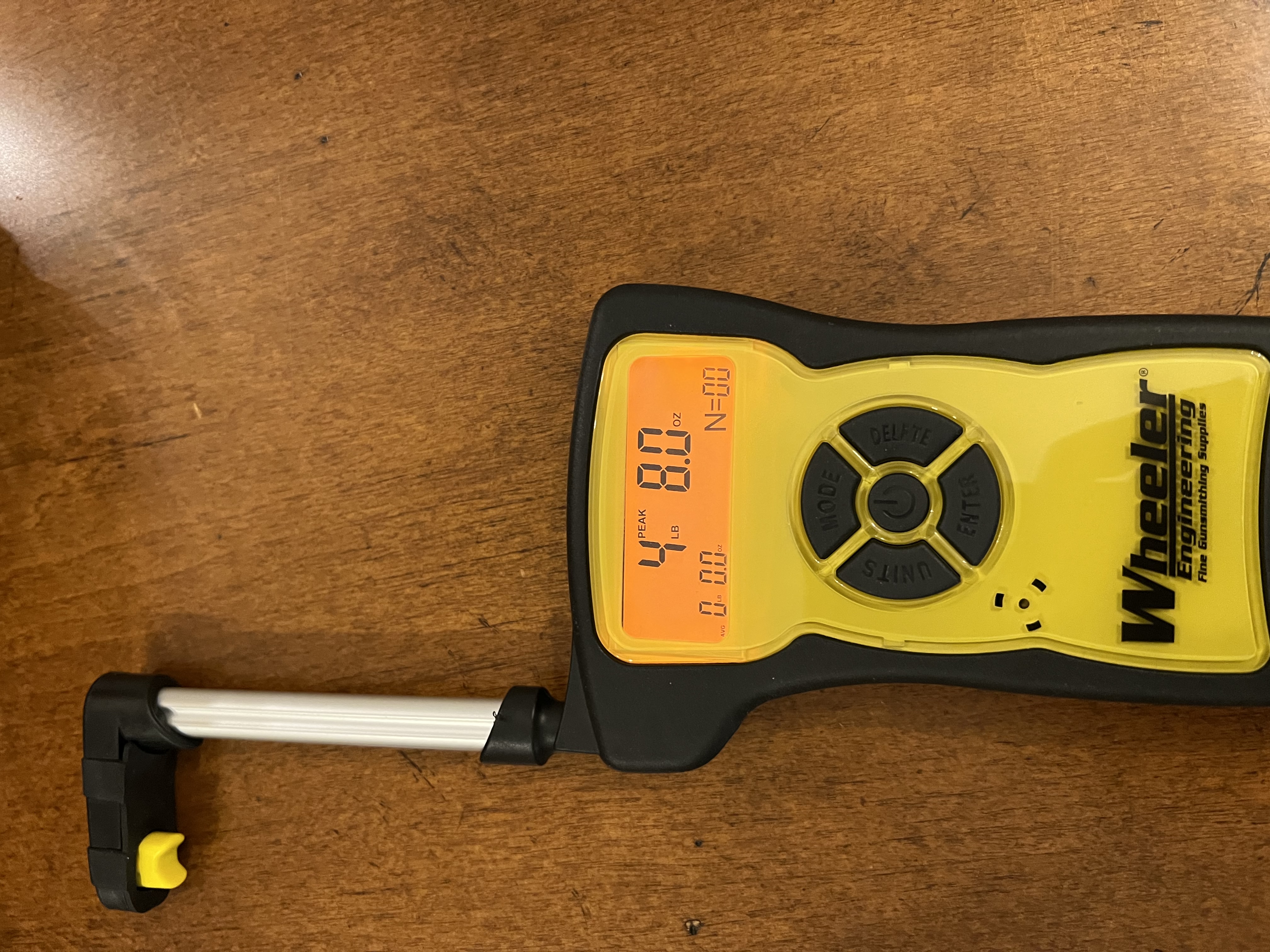

Had done the cz po-7 trigger kit successfully, was thinking that the lcp max would be harder because of its small size. No worries, excellent mcarbo video tutorial. Also installed the mcarbo short reset flat trigger and stainless steel guide rod. Installation went fairly easy, used the 10# hammer spring. Trigger pull reduced from 4# 3 oz to 2# 3 oz on my digital trigger gauge. Going to range test it tomorrow to see if I want to install the 12# hammer spring. PS: the annoying loud trigger clicking noise os gone.

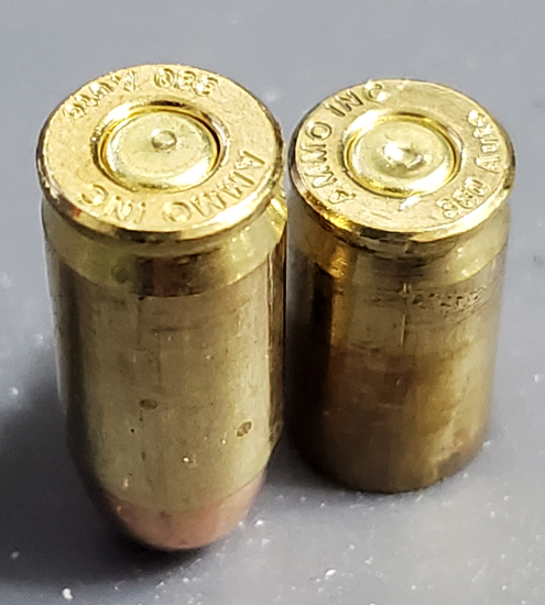

Light primer strikes
Installed 12lb trigger spring. Left stock firing pin spring in. Greatly redudced trigger pull, but completley failed to fire anything I tried. If you depend on the ruger max to protect yourself, do not install this garbage.
