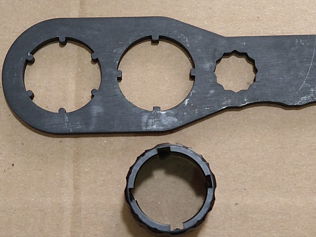

The Sub 2000 Armorer wrench collar remover didn't work on my Sub 2000 plastic collar.
The tool itself is a nice heavy metal tool, but I was displeased with the wrench as far as being a "needed" tool to upgrade my Sub 2000. The updated plastic collar design is larger than the two tool's collar holes, so neither collar holes will work (see picture). The Sub 2000 Armorer wrench needs to be updated or MCarbo needs to state that - "plastic collars are slightly bigger and will not work with this tool".
The C clip tool did work, but not like you would expect. The tool pointed flare needs to rest on the clip (past the opening, not "on" the opening of the clip) "and then forced outward - see video.
