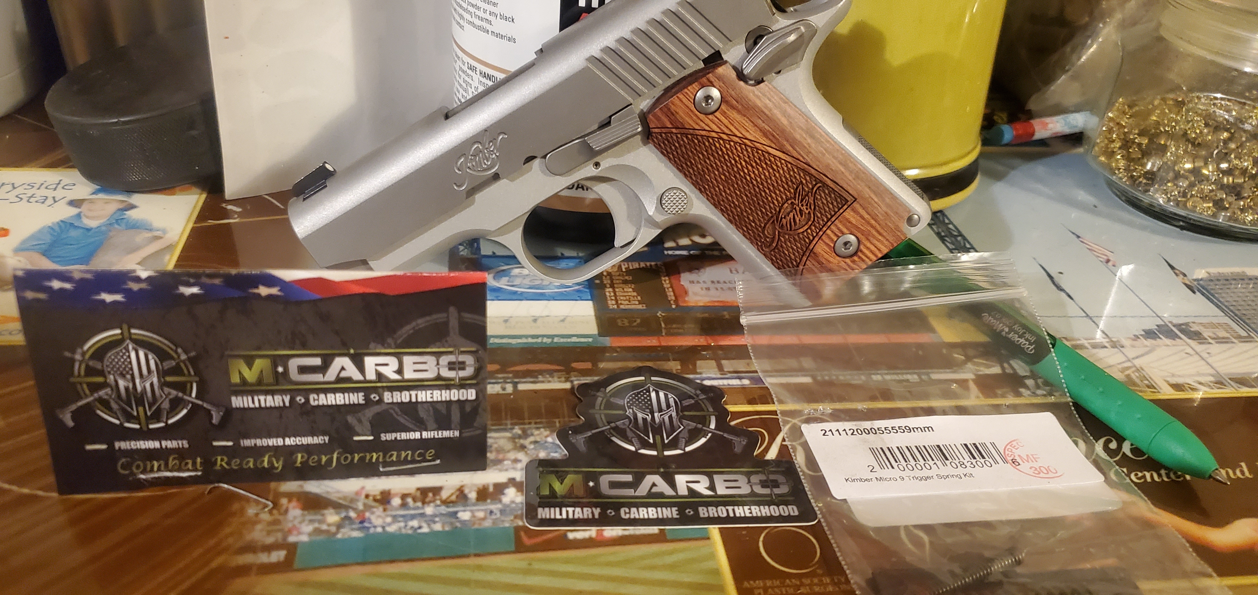

If you want to noticeably improve the trigger pull on your micro 9, this is the solution. Follow the video instructions carefully using proper tools and the job is not too difficult. At least a 40% improvement and no more “crunchiness” that I would feel before the kit was installed.

Kimber makes great firearms and the Micro 9 is certainly no exception. The MCARBO trigger spring kit I installed on my Micro 9 made a huge difference in my ability to shoot tight groups by reducing the trigger pull to 3 pounds, exactly as advertised. It’s easy to install by watching the video. I highly recommend this kit.

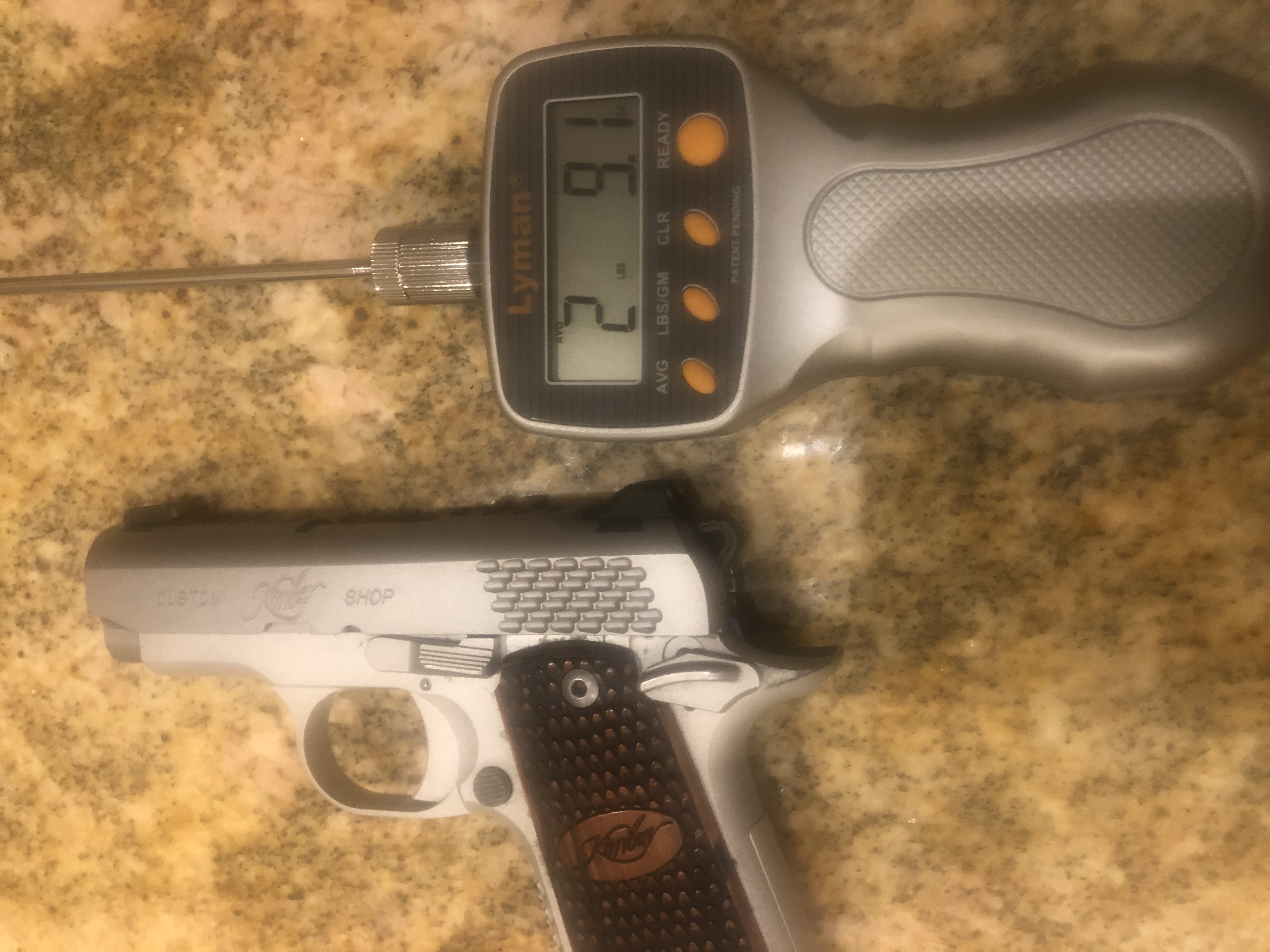

Bought the spring kit for my Raptor Micro 9, first tested the pull numbers before and after. After the cleaning and install the 5 pull average turned out to be 2.91, Holy Crap big difference from 5.43 average.

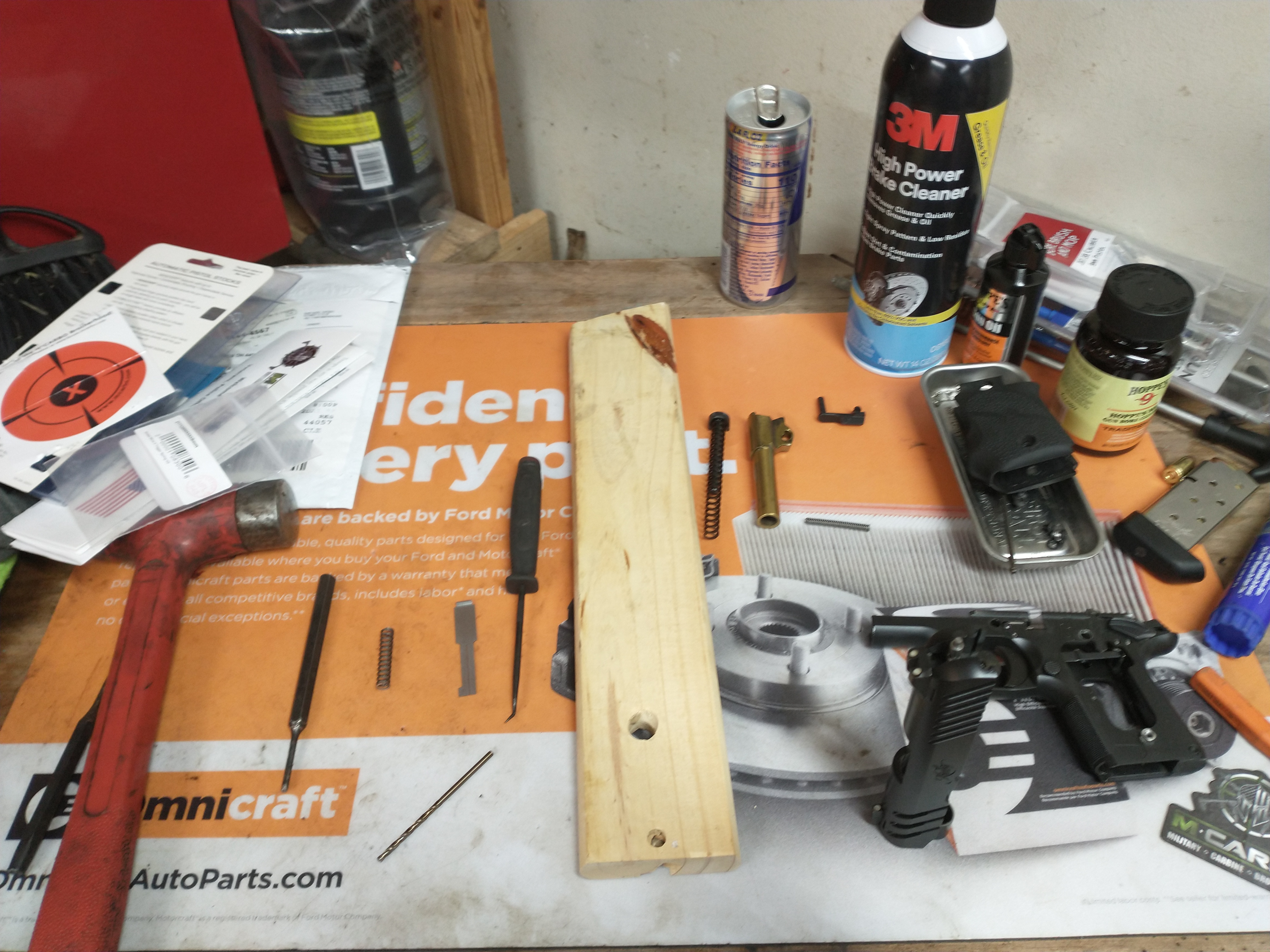

Fairly straight-forward install. Used the video as a guide. Didn't have to take the sear/ejector assembly out though. With some patience and playing around with the angle of the sear spring it will drop in correctly. You might have to push on it through the magwell some to get it to clear the ejector. Overall very happy with the new trigger weight. Makes it a whole different pistol and much more enjoyable.

Fairly straight forward installation. Instructions provided are well illustrated and thought out. Did have a little trouble reinstalling the sear, but that was mostly my fat fingers at fault there. Would definately recommend for this pistol

The trigger pull now is amazing! I also got bought the punches, hammer and block to help with tear down and install. Glad I spent the extra money for the tools.

I just purchased my micro 9 a week ago and wasn't impressed with the trigger pull especially a single action gun. I installed the micro 9 trigger kit and wow its about half of what it was down around 3.2lbs. Love it
