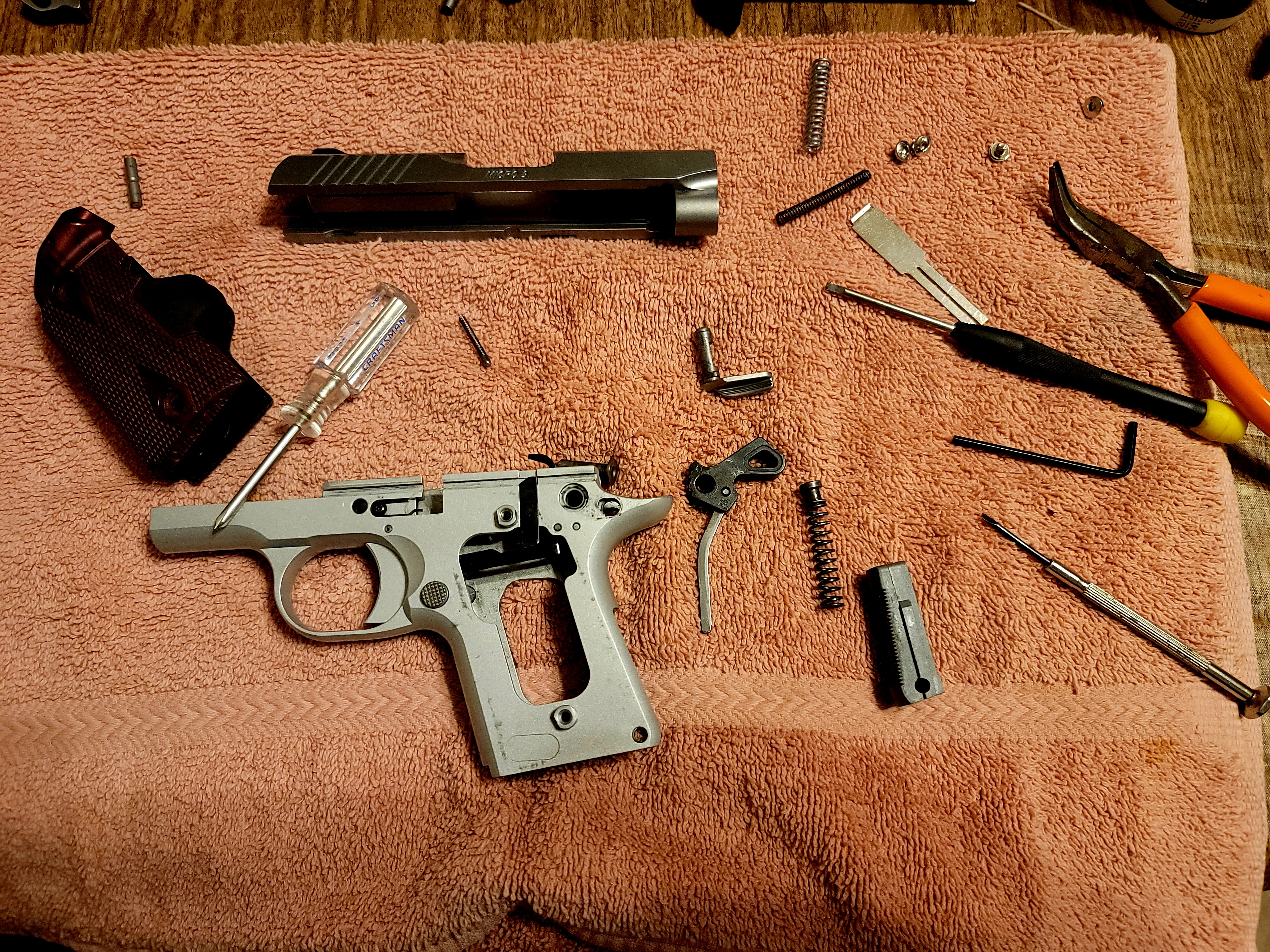

Spring kit was installed along with a new trigger. Before installing the new parts, the wife's Micro had a 9lb 14oz pull, Average of 10 pulls. Afterwards, trigger pull is 5lb 3oz, 10 pull average. Kit produced better than the advertised 40% reduction. Kit was easy to install, spent less than 30 mins to install trigger and springs.

Installed the M-Carbo trigger kit into fairly new Kimber Micro 9 9mm; installation took about 30 minutes but that was me taking my time. Trigger pull was actually off the scale of my manual Wheeler gauge ( 8+lbs) but with M-Carbo trigger kit it is now a nice 5lb trigger!

Install was easy and didn't require any fitting so they probably fell into the acceptable dimensional tolerances. the gun itself is a basic 1944 type so if you're familiar with that it's easy, 25 minutes for me even though I shot a spring across my shop.
Results were good but not as great as I would expect. Factory springs gave me trigger pulls of 6lb. 3.0oz., 7lb. 0.5oz, 7lb. 5.5oz., 7lb., 12.6oz., 7lb. 5.6oz. and 6lb. 14.8oz. The average was 7lb. 1.7oz. The low pull was 6lb. 3.0oz, high pull was 7lb. 12.60oz and variance was 1lb. 9.6oz which is quite large.
M-Carbo springs gave me pulls of 5lb. 9.6oz., 5lb. 13.8oz., 5lb. 12.5oz., 6lb. 1.6oz., 5lb 13.4oz. and 5lb. 11.7oz. The average was 5lb. 13.4oz. The low pull was 5lb. 9.6oz., high pull was 6lb. 1.6oz. and the variance was 0lb. 8.0oz. (1/2 pound) which I thought was excellent for 3" barrel carry gun and says the quality is good.
Overall I am satisfied with the results I got with the change. I would have liked a little lower trigger pull, close to a full pound lower would have been nice. The new the trigger pull is very smooth and has a very low variance in the weight making it very smooth. As I shoot it more I will see how it wears in and if the pull reduces at all. after 500 rounds or so if the pull is still a little high I will polish some parts down and see about reducing the pull a little more but for a carry gun this probably tolerable.
