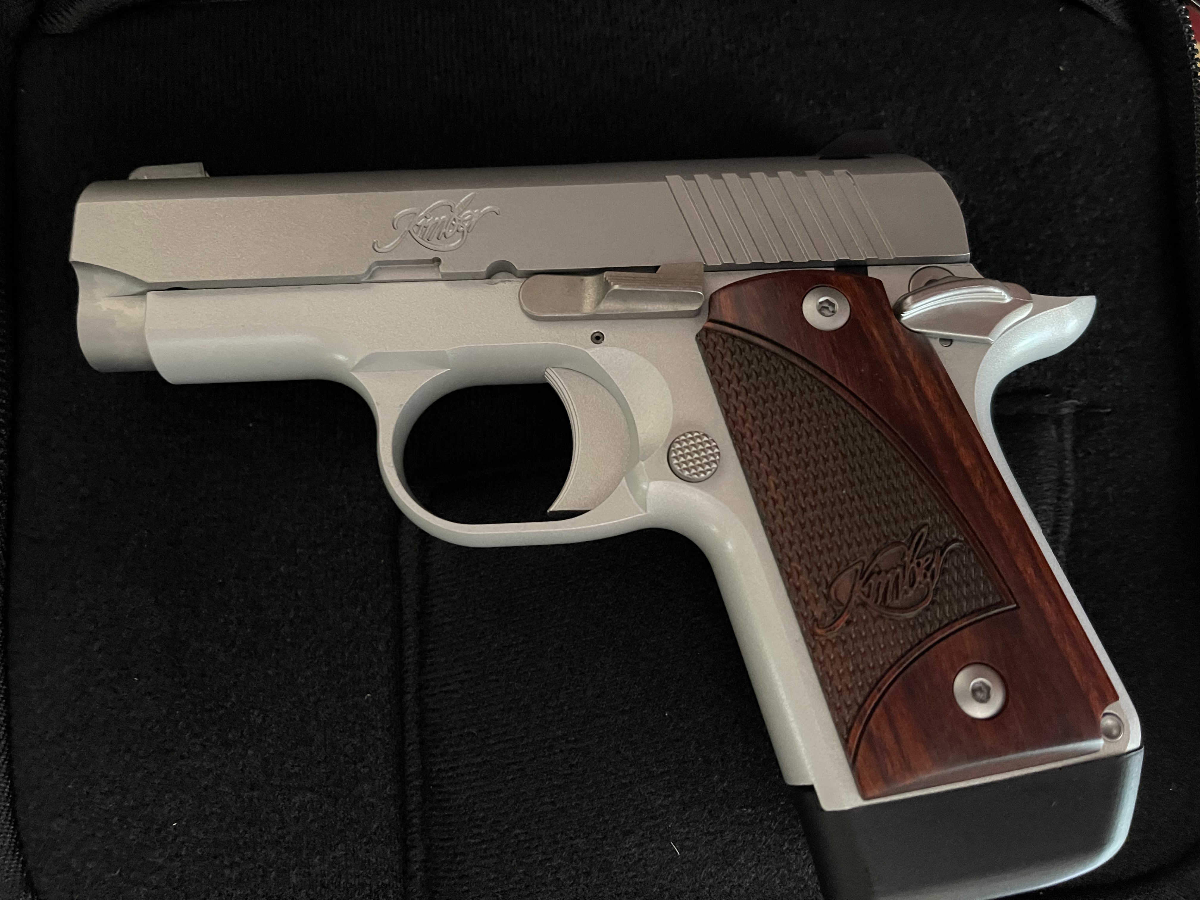

Replacing trigger parts for Kimber Micro 9
