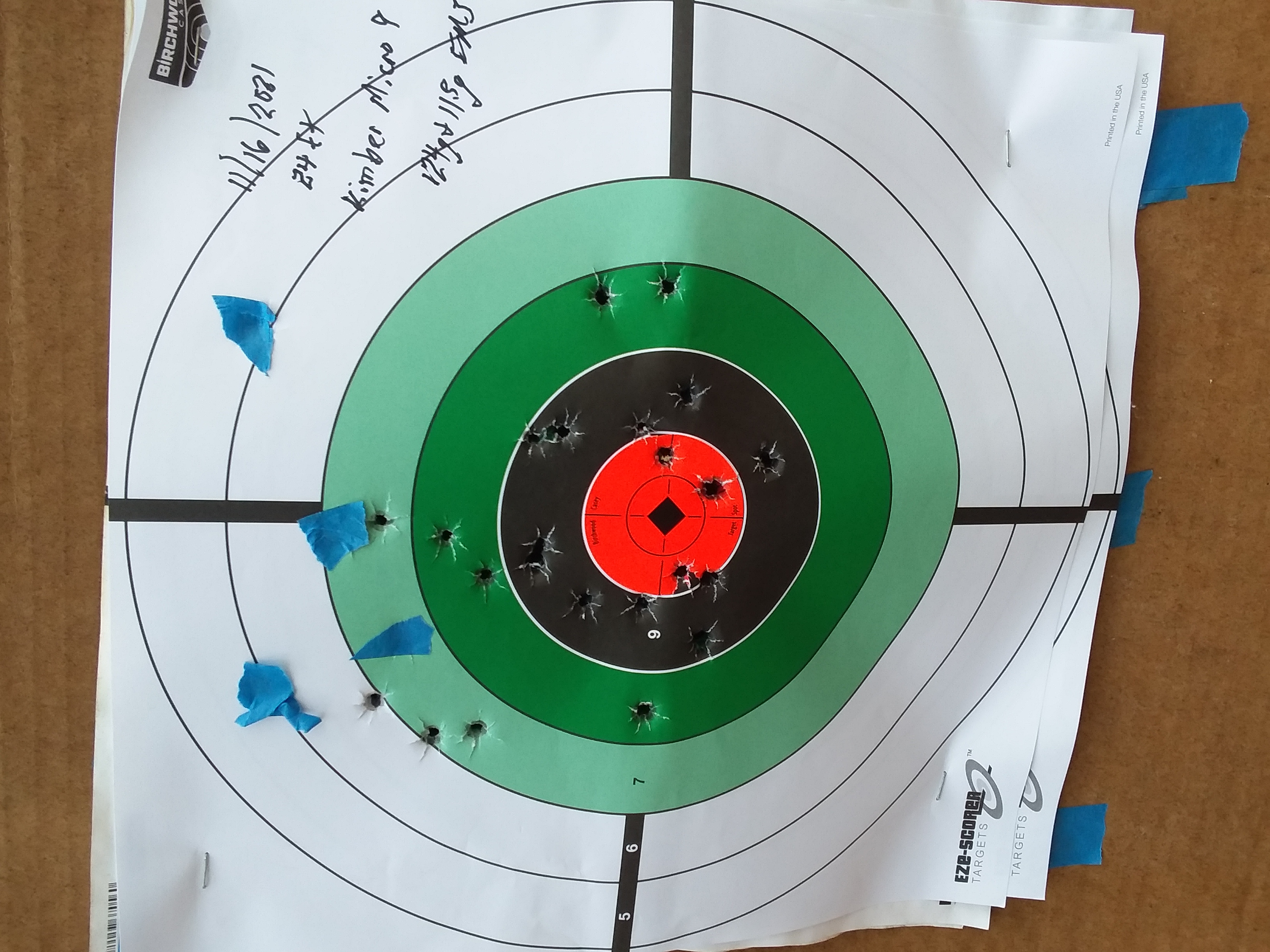

Spring Kit
Went to the range this weekend to try the new spring kit on my Micro 9 and it shot great. I highly recommend it.
