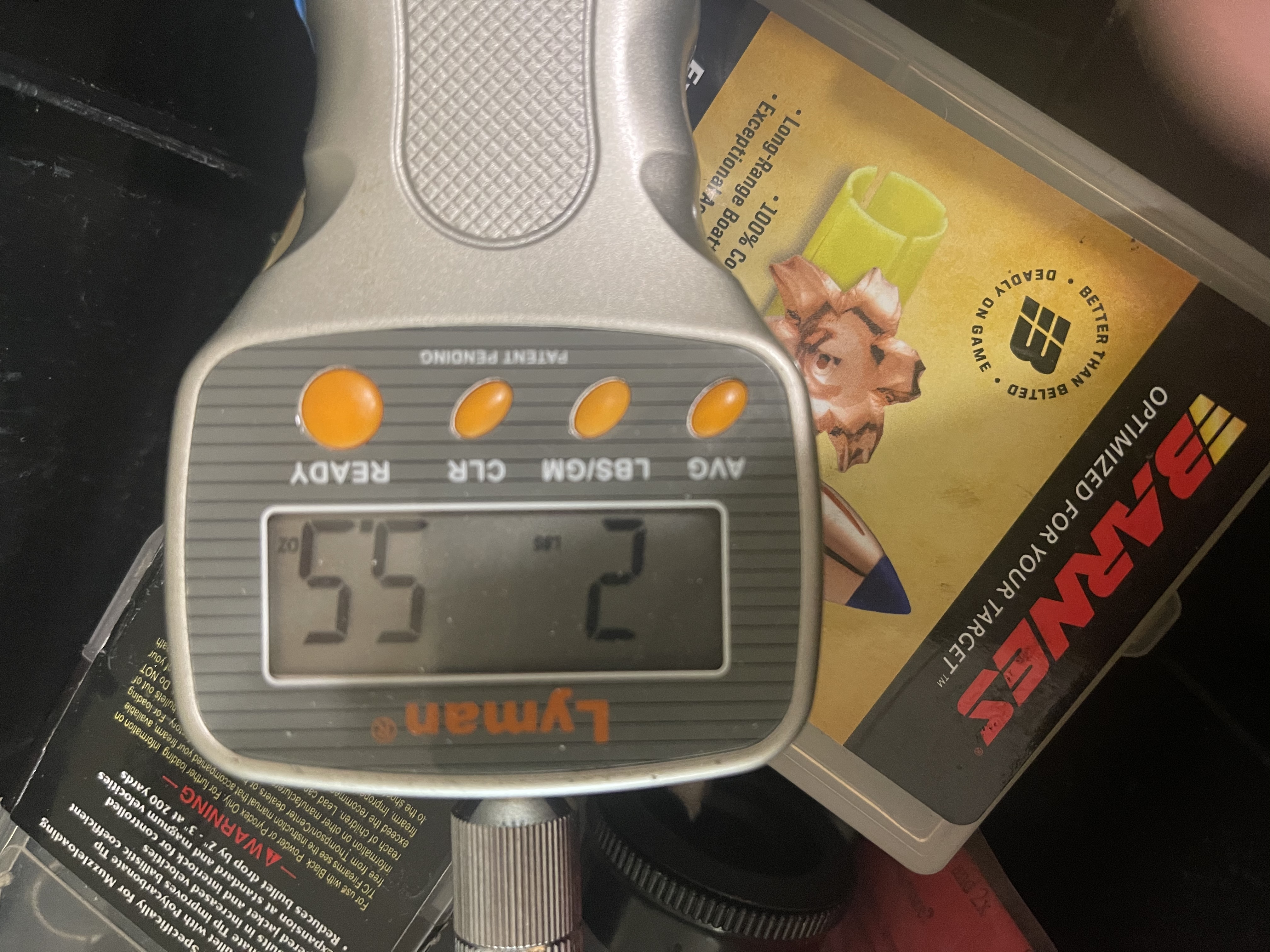

Huge upgrade from my factory triggers. I swapped out 2 sets one ended up at 2lbs 5.5oz and the other 2 lbs 7 oz. I am very happy with these results. They started at 4lbs 9oz and 5lbs 14oz.

Bought two kits. Easy to follow video available on how to. Also, trigger pull results were excellent. On blued Encore TP was 1.5 lbs, on Stainless Encore TP was 2.1 lbs.
