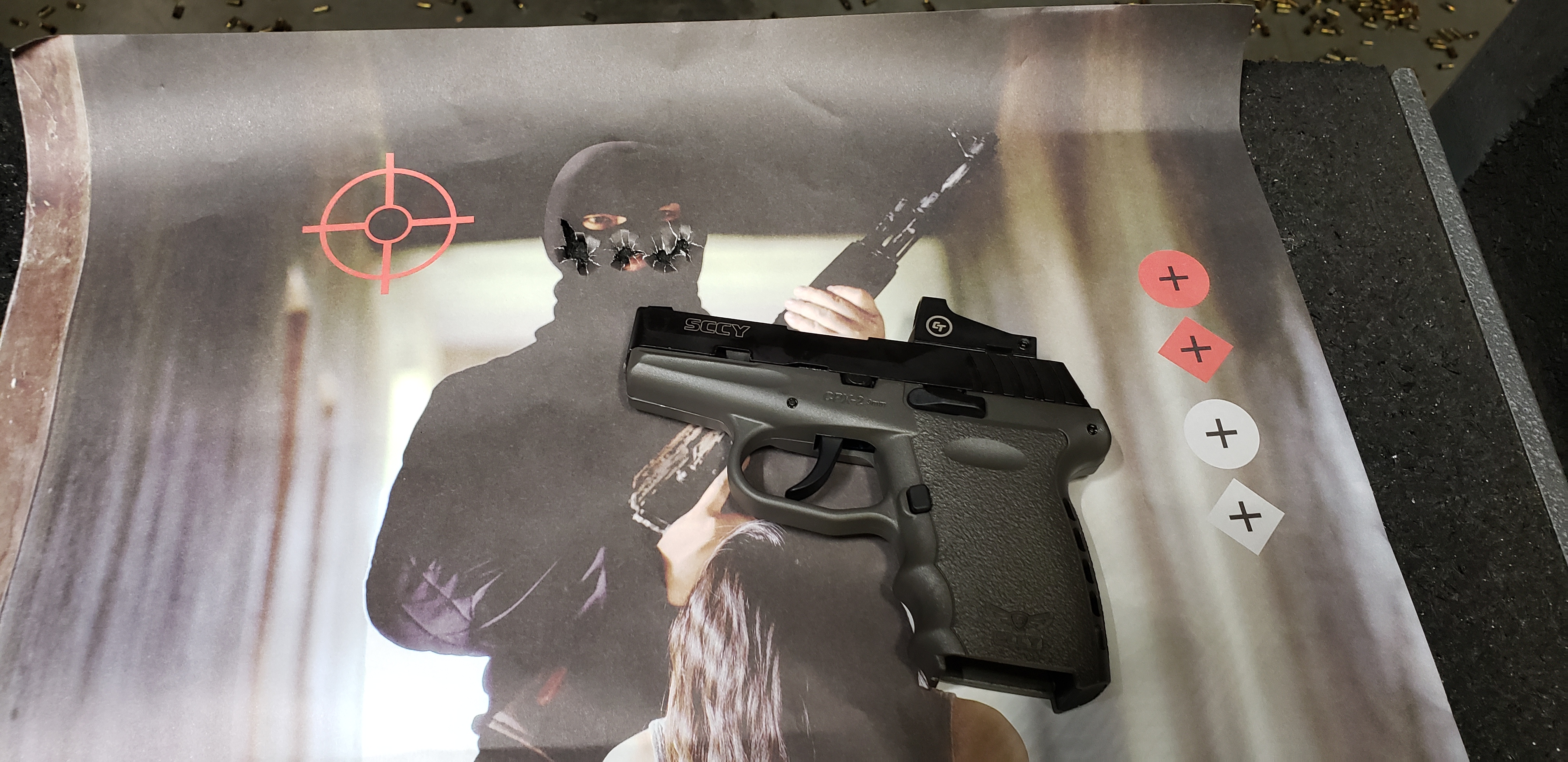

I did a spring kit on a brand new CPX-2 Red Dot. I watched the installation video which was excellent. A few tips to share. Being a brand new gun the frame pins were very tight. The 3/32 Punch was a hair too large once I got the pins started I had to move to a smaller punch, then they came out easily. Just have a size or two smaller available for the job.
After installation, I made a range trip and it has become a brand new pistol compared to stock. The trigger is very light and smooth. You still have to let it come all the forward to reset, as a short stroke will result in a dead trigger. My results at 25 yards at an indoor range with the factory crimson trace red dot are on the attached photo. Don't be afraid to follow the video and do the install yourself, well worth the money. Great product.
