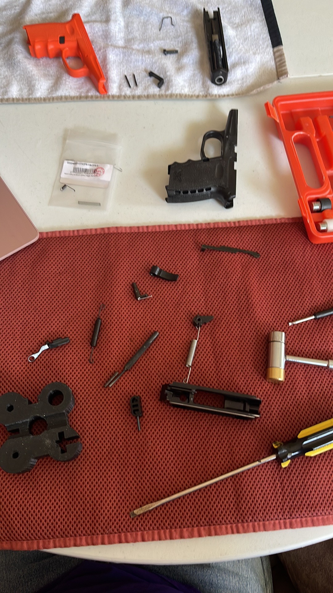

This kit, in conjunction with the step by step YouTube install video, is solid gold. I was interested in swapping frames but the Sccy website lists it as “professional gunsmith installation only”, so the thought of complete disassembly for this kit was daunting. I bought two of these kits and two brand new CPX-2s. I won’t lie, I had a TON of trouble with the first one. The frame pins just wouldn’t budge. I spray lubed, used a full sized hammered it, even froze the frame overnight. Eventually it came free, and it took all of 15 minutes to complete the kit install. The second gun from start to finish might have taken 10 minutes so I guess something freaky was going on with the polymer in the first gun. Regardless, the product and video are fantastic even for a first timer!
