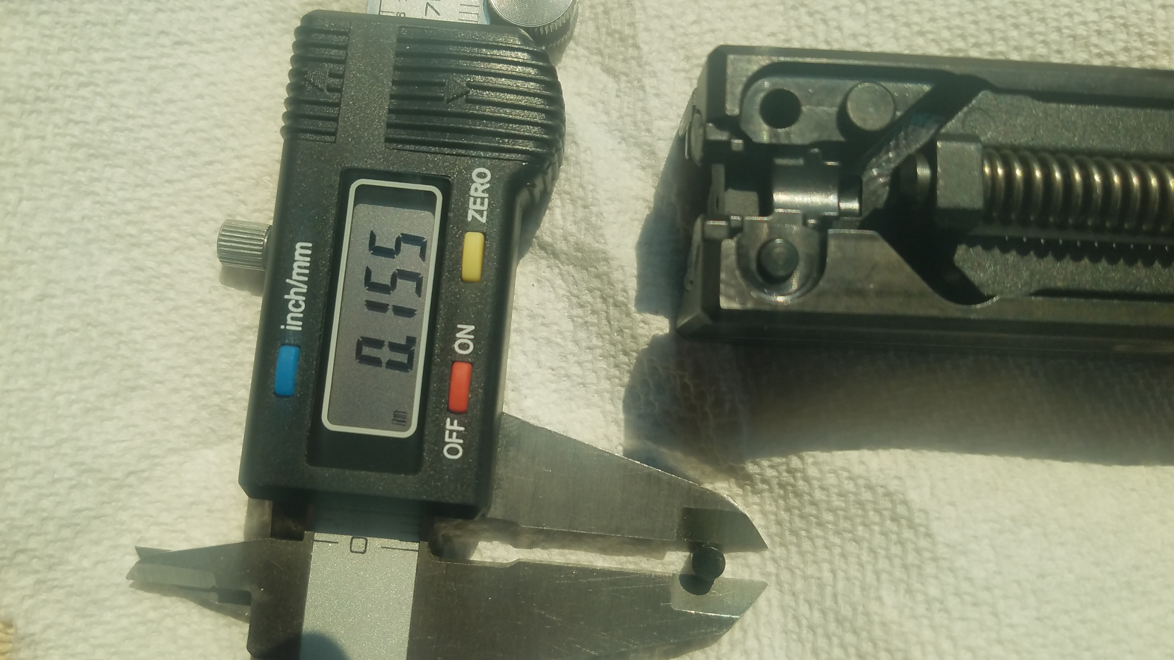

Bolt head pins not for my pc40
The pins in my pc40 are not the same as mcarbo pins. My pins do no have a flaired head they are just cylindrical. My pins measure .002 over the mcarbo pins. Upon return mcarbo said my pins are not standard? Really? Beware pins that wobble.
Bolt Head Pins Wouldn't fit
Tried to install the bolt head pins but they wouldn't fit (they were about 0.001" bigger in diameter than stock pins). The extractor pin was used with the MCarbo extractor and worked fine.
